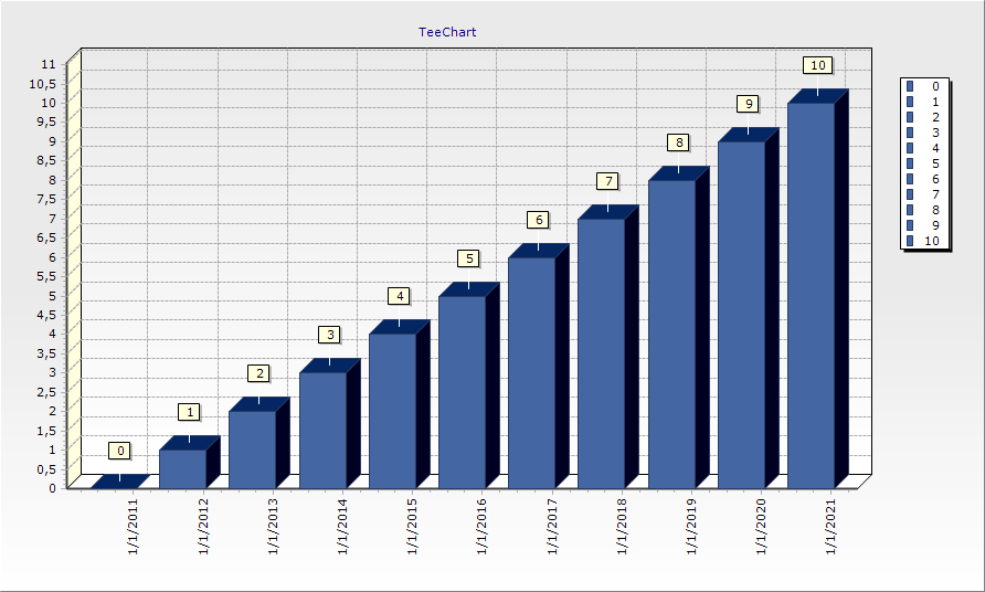

UserLS wrote:bring your chart editor and just change the bottom axis increment to your predefined option "One Year"
This can be done also by code with:
_testChart.Axes.Bottom.Increment = Steema.TeeChart.Utils.GetDateTimeStep(Steema.TeeChart.DateTimeSteps.OneYear);
With you code, and setting the Increment to "OneYerar" I get this:
And after adding the following line:
_testChart.Axes.Bottom.Labels.Style = Steema.TeeChart.AxisLabelStyle.PointValue;
I get this:

I have downloaded and tested the new build 4.1.2010.9280 and for the most part it corrects the problem with labels not aligning correctly with bars by using the new feature PointValue as an Asis Label Style.
However, if the series of data to be plotted is missing some periods the labels aren't shown on the chart, instead a gap is shown, see the following chart where there is no data for April. This chart uses the PointValue axis label style.
11-10-2010 06-49-30.png (7.07 KiB) Viewed 42885 times
Compared with this chart using the Auto axis label style.
11-10-2010 06-51-55.png (7.53 KiB) Viewed 42888 times
Both charts have axis increment set to one month and in all other aspects are identical.
Is it possible to have the PointValue axis label style show the missing data label?

Re: X asix labels not lining up properly
Post by Yeray » Mon Oct 11, 2010 8:50 am
Hi Captell,
The PointValue AxisLabelStyle draws the label *only* where there is a point. This style doesn't cares about Increment and IncrementOffset (neither Mark or Text AxisLabelStyle).
Alternatively, if you want to draw labels in a constant separation (regardless of points positions) you have to use Increment and IncrementOffset (with Value AxisLabelStyle).
