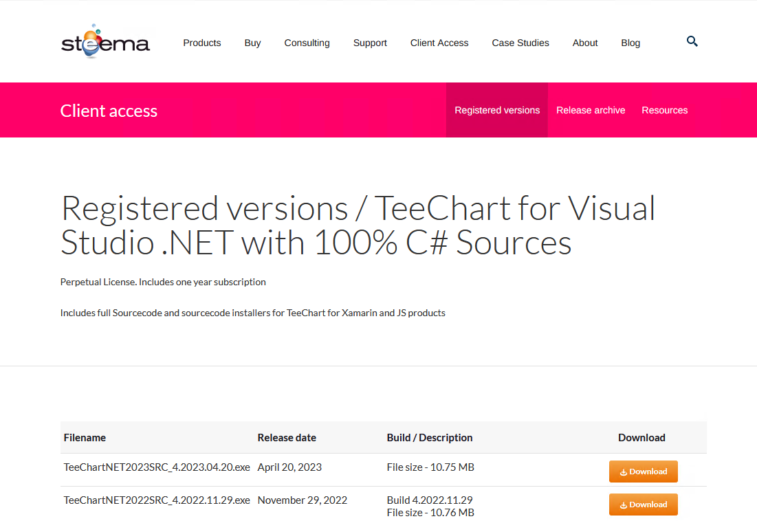

The sourcecode version is now available from our Client access page, as usual:
Screenshot from 2023-04-20 12-12-12.png (94.93 KiB) Viewed 16458 times
Please note that:
1. the source code version does not have the code that runs our licensing
2. I didn't add in that feature release for the Export editor, as this source code version is identical to the code that built the latest NuGet binary version
I don't think 2) is going to be an issue, as the change is trivial and I'm sure you'll be able to modify the code to your needs.
