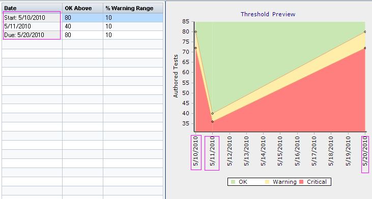

Hi ,
See the attachment - In my chart I have 3 area series and on the lest I have the values of the series.
I want to show only the dates that have value in the series.

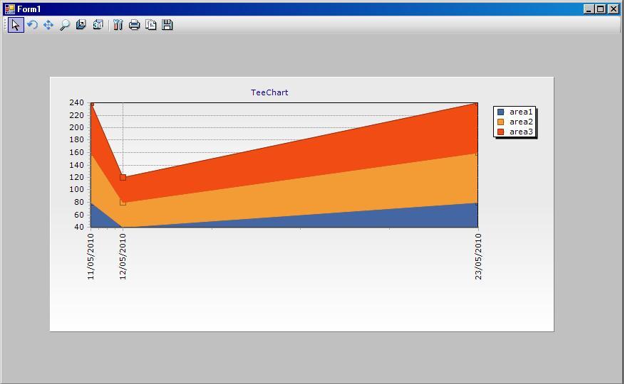

Also, I have attached an image, because you could see our results that we have obtained with previous code:
If you don't get same results, with our code or it doesn't works as you want, please modify code or explain exactly what we must do to reproduce your problem.

Your example is good and work exactly as I want.
But in my solution on my chart I got all the days between.
Do yo know what property can cause this behavior?

Hi qcrnd,
Have you tried adding axis labels directly when populating the series as Sandra did?

You are right - I missed this part .
Now it works OK:)
