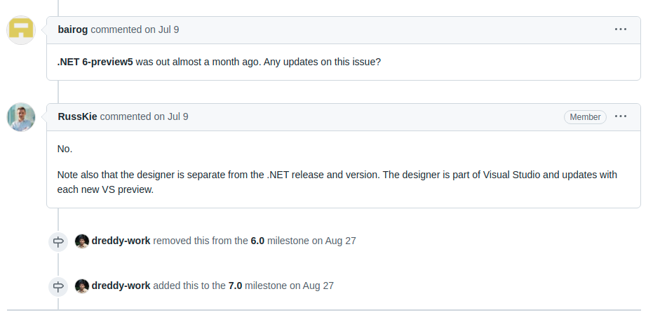

Using the code on the issue itself, I've just run it using .NET 6 SDK version 6.0.100-rc.2.21505.57 in Microsoft Visual Studio Enterprise 2022 Preview (64-bit) Version 17.0.0 Preview 5.0, using .NET 6 as the target Framework in the Core4451 project. Unfortunately the issue can still be reproduced - it works in .NET Framework 4.8, but doesn't work in .NET 6.
On the issue itself I see they've changed the milestone from .NET 6 to .NET 7:
Screenshot from 2021-10-14 09-38-16.png (52.34 KiB) Viewed 30989 times
I'm therefore not sure what more we can do at this stage to resolve this issue.
I've duplicated the description of you experience on the issue topic.
Christopher wrote:
Thu Oct 14, 2021 8:30 am
As RussKie said The designer is separate from the .NET version, it is part of Visual Studio and updates with each new VS preview.
So looking foward for finally fixing that in one of the upcoming Visual Studio 2022 previews..
