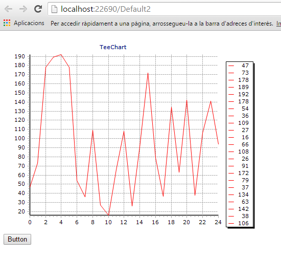

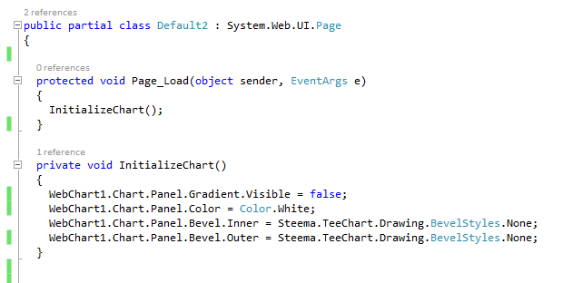

Priyanka wrote: I tried it but no luck.
Here is the code I am using with the latest version of TeeChart.dll:
and this is the result:

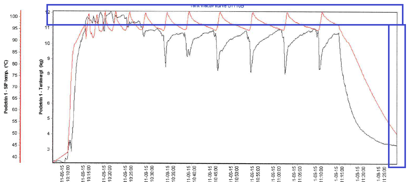

It removed extra borders. However, I need top and right border to only chart area as attached.

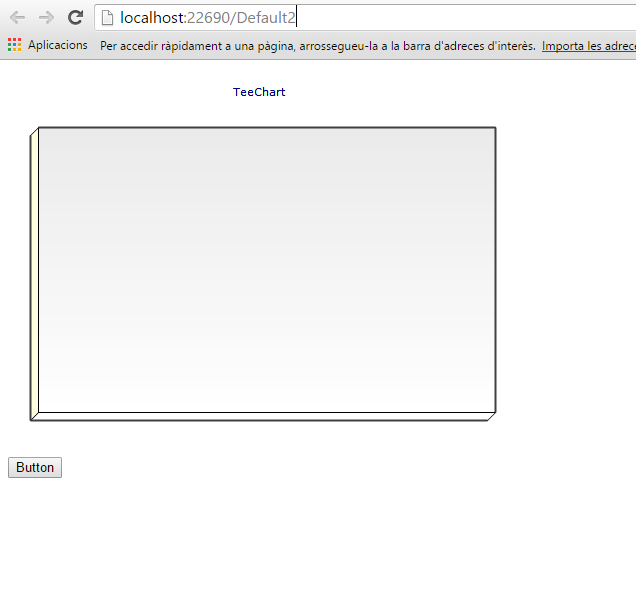

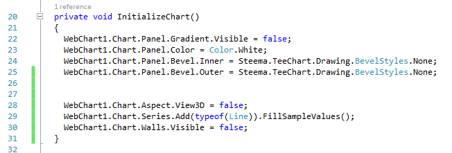

Post by Christopher » Wed Jun 01, 2016 8:31 am
Priyanka wrote:However, I need top and right border to only chart area as attached.
This code:
gives me this result, without the borders you mention:

I think you got confused. I need top and bottom border to only chart area.

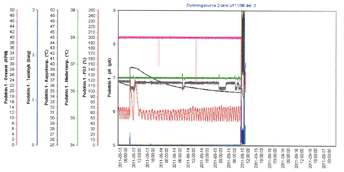

Need your help to implement requirement of showing blank report. As per attached screenshot. We need to draw series for some date range and rest should be blank.
Re: Bottom and Custom Vertical Axis Label Start Position
Post by Christopher » Mon Jun 06, 2016 8:27 am
Priyanka wrote:Need your help to implement requirement of showing blank report. As per attached screenshot. We need to draw series for some date range and rest should be blank.
Can you not simply set the bottom Axis's SetMinMax to a relevant value? Or is the situation more complex than this? If so, how?

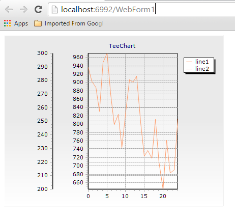

This code:
    protected void Page_Load(object sender, EventArgs e)
      Chart chart = WebChart1.Chart;
      chart.Aspect.View3D = false;
      chart.Series.Add(typeof(Line)).FillSampleValues();
      chart.Panel.MarginLeft = 30;
      Axis axis = chart.Axes.Custom.Add();
      axis.Horizontal = false;
      axis.RelativePosition = -40;
      axis.PositionUnits = PositionUnits.Percent;
      axis.SetMinMax(200, 300);
      chart[1].CustomVertAxis = axis;
gives me the following (depending on the random values of FillSampleValues, of course):

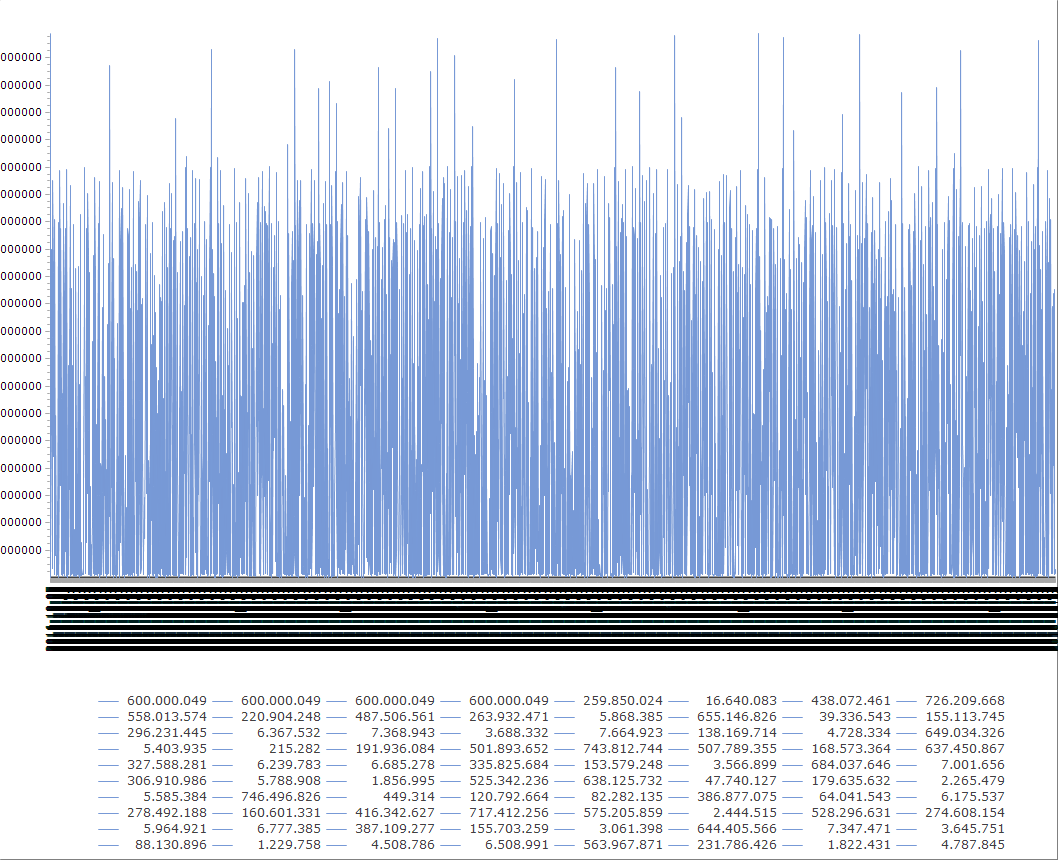

Attached is the output of the code shared by me. Not sure why the below code is not working in case of custom vertical axis
WebChart1.Chart[0].CustomVertAxis.Automatic = false;
WebChart1.Chart[0].CustomVertAxis.SetMinMax(0.3, maxvalue);
Also, need inputs on setting chart resolution and exporting chart in binary format.
Appreciate your help.

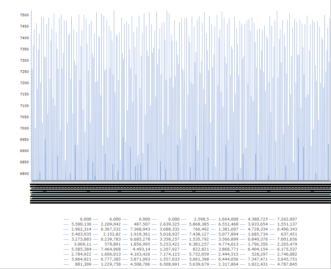

Priyanka wrote:Hi Christopher,
It is working here. This code:
        WebChart1.Chart[0].CustomVertAxis.SetMinMax(maxvalue - (maxvalue / 10), maxvalue);
gives me this:
