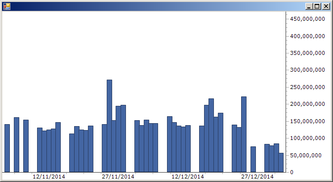

Also we found that RemoveGaps property is only available for some of the chart types like Candle. But it is not available for Bar chart or Volume chart. For example following code example gives us chart having gaps for weekend, which is an error.

Bar newBarSeries = new Bar();
newBarSeries.VertAxis = VerticalAxis.Right;
this.tChart1.Series.Add(newBarSeries);
for (int i = 0; i < CashVolume.Rows.Count; i++)
	date = (DateTime)CashVolume.Rows[i][(int)Graph.CashVolumeCol.TimeStamp];
	vol = (int)(CashVolume.Rows[i][(int)Graph.CashVolumeCol.Volume]);
	newBarSeries.Add(date, vol);
Bar Chart Having Space for Weekend
Bar Chart.png (12.66 KiB) Viewed 6126 times
It should be available for all available financial charts.

Quant wrote: Also we found that RemoveGaps property is only available for some of the chart types like Candle. But it is not available for Bar chart or Volume chart. For example following code example gives us chart having gaps for weekend, which is an error.
