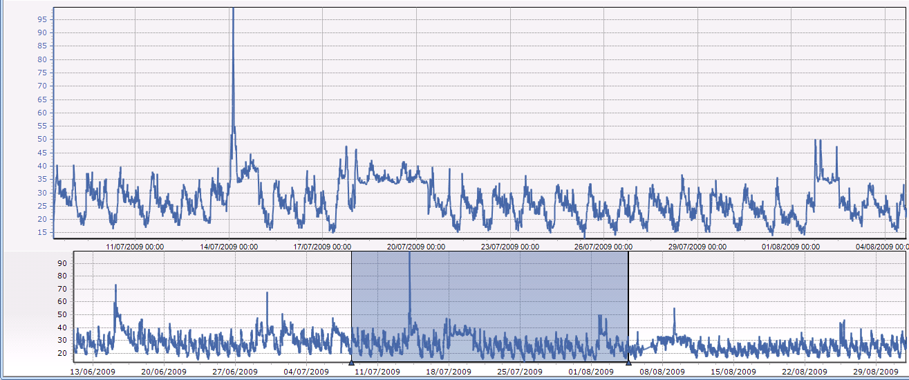

I have just tried I put:
((ScrollPager)chart.Tools[i]).SubChartTChart.Chart.CustomChartRect = true;
((ScrollPager)chart.Tools[i]).SubChartTChart.Chart.ChartRect = rect;
It runs, I put the same "rect" as the main chart, but the margin is not exactly the same:

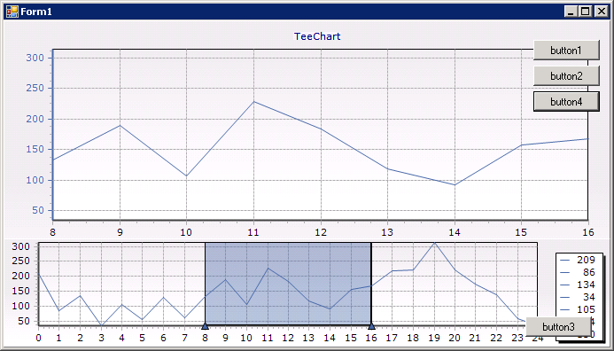

Please press buttons1, 2 and 4

Re: ScrollPager doesn't respect the margin of customaxis
Post by Christopher » Thu Mar 13, 2014 12:18 pm
wakeup wrote:Please press buttons1, 2 and 4
The way to do this would be with code such as the following:
        void SubChartTChart_GetAxesChartRect(object sender, Steema.TeeChart.GetAxesChartRectEventArgs e)
          if (tChart1.Series[0].CustomVertAxis != null)
            Rectangle chartRect = tChart1.Chart.ChartRect;
            Rectangle rect = e.AxesChartRect;
            rect.X = chartRect.X;
            rect.Width = chartRect.Width;
            e.AxesChartRect = rect;
          mt = new Steema.TeeChart.Tools.ScrollPager(tChart1.Chart);
          for (int i = 0; i < tChart1.Series.Count; i++)
            if (tChart1.Series[i].Count > 0)
              mt.Series = tChart1.Series[i];
          mt.SubChartTChart.GetAxesChartRect += SubChartTChart_GetAxesChartRect;
        void tChart1_BeforeDraw(object sender, Steema.TeeChart.Drawing.Graphics3D g)
          double maxVal = tChart1.Series[0].YValues.Maximum;
          float twidth = tChart1.Graphics3D.TextWidth(maxVal.ToString(tChart1.Series[0].CustomVertAxis.Labels.ValueFormat));
          int width = Steema.TeeChart.Utils.Round(twidth) + 30;
          rect.X = width;
          rect.Width = tChart1.Width - 80;
          tChart1.Chart.ChartRect = rect;
          mt.SubChartTChart.Legend.Visible = false;
However, because of defect id=632 (now fixed), you can see that the axis labels aren't lined up correctly.
