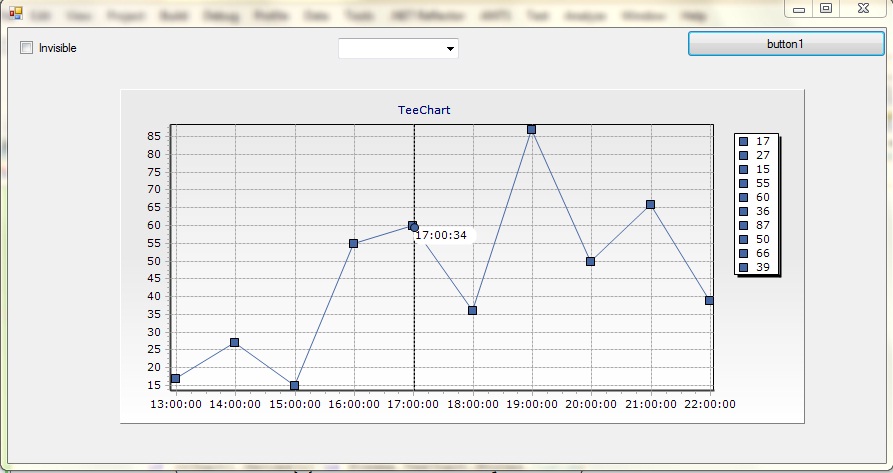

Re: Index outside the bounds of the array.
Post by Sandra » Fri May 04, 2012 11:22 am
Hello Petter,
Using last version 4 and previous code I have attached in this thread I am get next results:
I think code works as I expect. Can you tell please what version are you using now? The problem doesn't occur in last version of TeeChartFor.Net.
Post by Sandra » Fri May 04, 2012 2:07 pm
Hello Petter,
OK. I have attached my project where I have added a cursor tool and an annotation tool that works as a label where its text is in DateTime format. Using this project, I have gotten the results you have seen in the image I have attached in previous post.
