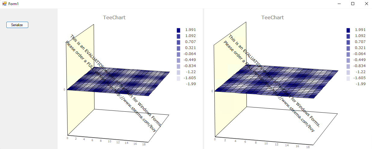

No, I can see what you mean—certainly it's easier with a code example, and I can reproduce what I believe is your issue modifying the code I sent you slightly:
      tChart1.Aspect.View3D = true;
      tChart1.Aspect.Zoom = 80;
      tChart1.Aspect.Chart3DPercent = 100;
      tChart1.Tools.Add(typeof(Rotate));
      var surface = new Surface(tChart1.Chart);
      int count = 20;
      for (int x = 0; x < count; x++)
        for (int z = 0; z < count; z++)
          double y = Math.Cos(x) + Math.Sin(z);
          surface.Add(x, y, z);
      tChart1.Axes.Left.Automatic = false; //set left axis to Automatic false
      using (var stream = new MemoryStream())
        tChart1.Export.Template.IncludeData = true; //default setting
        tChart1.Export.Template.Save(stream);
        stream.Position = 0;
        tChart2.Import.Template.Load(stream);
       //to get the same chart back we have to set these both to true
        tChart2.Axes.Bottom.Automatic = true;
        tChart2.Axes.Depth.Automatic = true;
Doing this gives me the same chart before and after the serialization, e.g.
Screenshot from 2022-03-17 11-17-31.png (119.45 KiB) Viewed 8906 times
I have added this issue to our issue-tracking software with id=2514, meaning that a fix to it will become available shortly.
