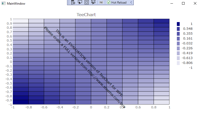

No. What I mean is that using the latest NuGet package, we can create a WPF application that doesn't reference TeeChart.Xaml.WPF:
Screenshot from 2021-04-28 10-30-39.png (98.56 KiB) Viewed 46243 times
Adding your data in at runtime:
Screenshot from 2021-04-28 10-31-05.png (26.57 KiB) Viewed 46243 times
Gives us the following:
Screenshot from 2021-04-28 10-29-45.png (49.88 KiB) Viewed 46243 times

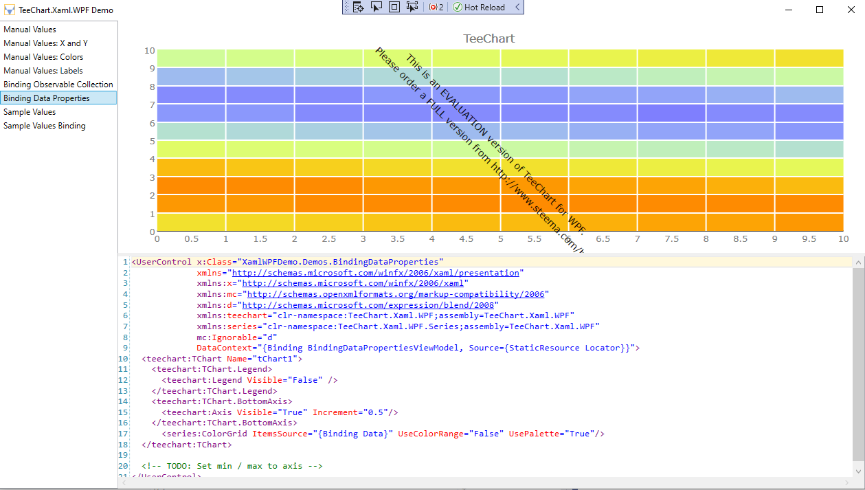

However, the TeeChart.Xaml.WPF assembly in the latest NuGet package does not contain the property IrregularGrid - we've added that in now, meaning that in a future version you will be able to do this:
Screenshot from 2021-04-28 10-26-19.png (39.74 KiB) Viewed 46243 times
To give you:
Screenshot from 2021-04-28 10-25-06.png (114.99 KiB) Viewed 46243 times

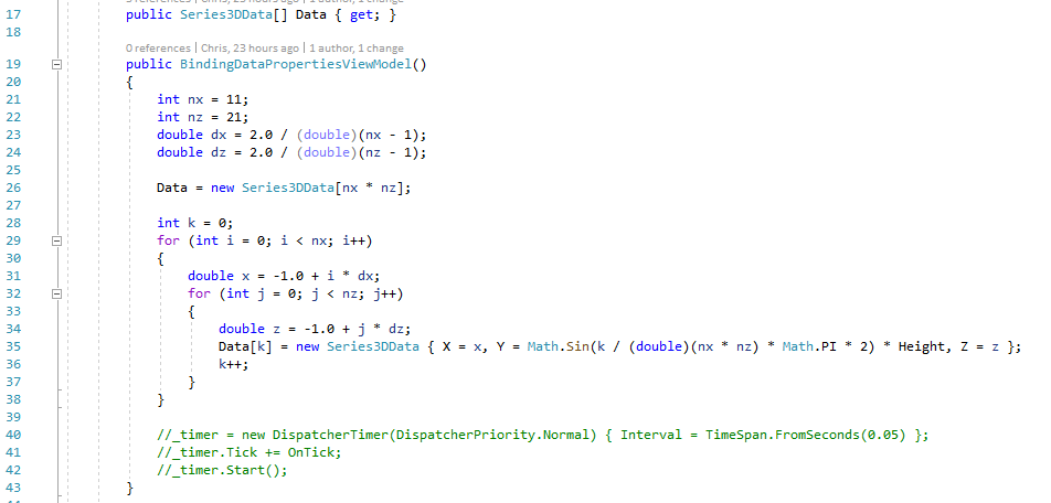

Thanks, I understand that setting colorgrid.IrregularGrid = true works. But, as you can see from the example, the data is regular except for numerical precision. It would be best that if the user sets IrregularGrid=false then ColorGrid should treat the data as regular and then find the stepsize. I am assuming that when IrregularGrid = true that teechart is doing some sort of interpolation and that there is a performance impact. In the example you can make a comparison by running the following two cases and look at performance when you resize the window.
Case 1:
colorgrid.IrregularGrid = true;
Data[k] = new Series3DData { X = x, Y = Math.Sin(k / (double)(nx * nz) * Math.PI * 2) * Height, Z = z };
Case 2:
colorgrid.IrregularGrid = false;
Data[k] = new Series3DData { X = i, Y = Math.Sin(k / (double)(nx * nz) * Math.PI * 2) * Height, Z = j };
Notice the changes in the two cases are:
x -> i
z -> j
Case 2 is much faster and responsive then Case 1
In addition, how can I remove the colorgrid gridlines in xaml?

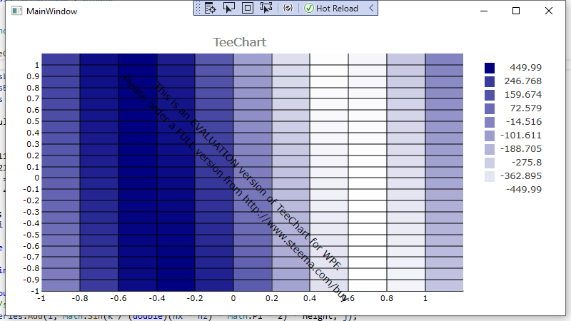

Post by Christopher » Fri Apr 30, 2021 10:59 am
Christopher wrote:
Wed Apr 28, 2021 8:36 am
Yes, if you had access to the source code you would be able to see that this is expected. Please let me briefly explain. RegularGrid and IrregularGrid are somewhat of a misnomer, as it would be more precise to call these properties 'OneStepGrid' and 'GreaterThanOneStepGrid'. For speed optimization, for not having to perform calculations to determine the step - which depends on the difference in value between one value and another, whether this value is constant throughout the added data or whether this value increases or decreases by specific factors - 'RegularGrid' assumes that the (x,z) grid has a step of one ('1'), meaning no such calculations have to be performed. The idea is that you can use this optimization to speedily render 'GreaterThanOneStepGrids' by retrofitting the axes labels, e.g.
        public MainWindow()
            var labelsLeft = new Dictionary<int, string>();
            var labelsBottom = new Dictionary<int, string>();
            var series = new ColorGrid(tChart1.Chart)
            int nx = 11;
            int nz = 21;
            double dx = 2.0 / (nx - 1);
            double dz = 2.0 / (nz - 1);
            int k = 0;
            for (int i = 0; i < nx; i++)
                double x = -1.0 + i * dx;
                for (int j = 0; j < nz; j++)
                    double z = -1.0 + j * dz;
                    //series.Add(x, Math.Sin(k / (double)(nx * nz) * Math.PI * 2) * Height, z);
                    series.Add(i, Math.Sin(k / (double)(nx * nz) * Math.PI * 2) * Height, j);
                    if (!labelsBottom.ContainsKey(i))
                        labelsBottom.Add(i, x.ToString());
                    if (!labelsLeft.ContainsKey(j))
                        labelsLeft.Add(j, z.ToString());
                    k++;
            foreach (var item in labelsBottom)
                tChart1.Axes.Bottom.Labels.Items.Add(item.Key, item.Value);
            foreach (var item in labelsLeft)
                tChart1.Axes.Left.Labels.Items.Add(item.Key, item.Value);
Which gives me this (a small bug in the present NuGet gives a slightly different result - this fix will be in the next NuGet):
Screenshot 2021-04-30 124313.png (57.18 KiB) Viewed 46224 times

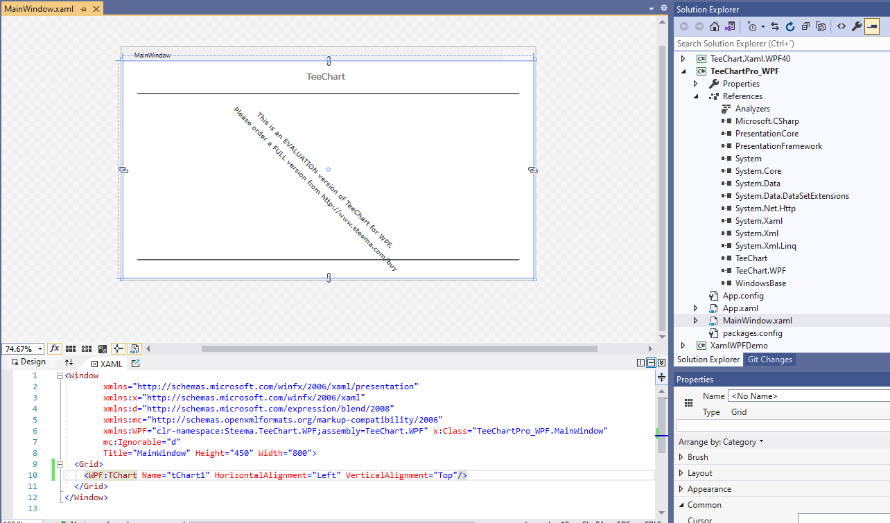

I am trying to implement your latest suggestions with reference to using a RegularGrid and setting tChart1.Axes.Bottom.Labels. To experiment I have followed your example in which you define the colorgrid in code behind. I can do this in .NET Framework but am having problems with .NET5. In my project I am using the Steema.TeeChart.NET50.WPF NuGet package. I have defined the TChart in xaml as "<teechart:TChart x:Name="tchart1">". However, I am having problems in the code behind when setting "var series = new ColorGrid(tchart1.Chart);". I get the following error:
"Error CS1061 'TChart' does not contain a definition for 'Chart' and no accessible extension method 'Chart' accepting a first argument of type 'TChart' could be found (are you missing a using directive or an assembly reference?)"
I am able to implement your suggestion only if I define the TChart in the code behind as:
var tChart = new TChart();
contentControl.Content = tChart;
var series = new ColorGrid(tChart.Chart)

Yes, it's not immediately obvious what's going on here.
Essentially, TChart has two assemblies for WPF:
  1. TeeChart.WPF.dll
  2. TeeChart.Xaml.WPF.dll
The second of these is a wrapper of the first, and enables TChart's objects (Series, Axes, Titles etc.) to be edited at designtime in Xaml. The first of these - TeeChart.WPF.dll - can be placed in Xaml, but none of its objects can be edited at designtime in Xaml.
There is a place where these two meet - that is, it is possible to extract the wrapped TChart instance of the first assembly when using the second - and I have added an example of how to do this here (and here). When you now open the ColorGrid binding example, you will see that the Grid Pen is now white and with a greater width.
Screenshot from 2021-05-04 11-56-30.png (109.17 KiB) Viewed 46122 times
It is in this way, if you so wished, that you could run the 'retrofitted label' code that we've been discussing in this thread while using the TeeChart.Xaml.WPF.dll assembly.

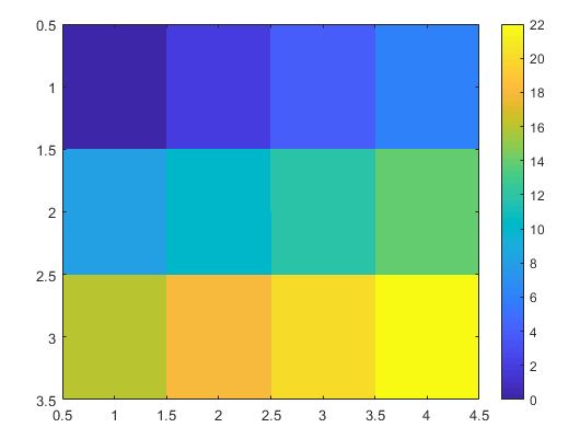

The figure above is not from TeeChart, it was generated from Matlab. I was using it as an example for a continuous legend bar. The post was to ask for Steema to add a HeatMap series that has the following signature
double Nx = 101;
double Ny = 201
double[] x = new double[Nx];
double[] y = new double[Ny];
double[,] data = new double[Ny,Nx];
//where x and y are uniformly spaced data.
HeatMap(double[] x, double[] y, double[,] data);
The HeatMap would be displayed with the legend as shown in the figure.
Sorry for the confusion, Does TeeChart have another series that already does this?
Re: WPF ColorGrid DataBinding
Post by Christopher » Fri May 07, 2021 2:20 pm
Christopher wrote:
Fri May 07, 2021 9:36 am
No. As I say, I've add a feature request for a Heat Map series into our issue tracker with id=2422.
