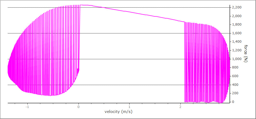

Thanks for your reply. I cannot figure out why there is a difference. With follow code:
For count = 0 To plotsamples
FastLineForce.Add(velocity(count + zoomstart), force(count + zoomstart))
Next count
I get the distorted graph attached. Some points are plotting correctly but then there is a sequence out and the back to correct etc.

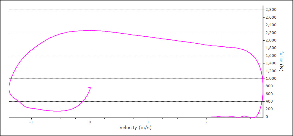

However, if I use the following code with the exact same data arrays:
xdata(count) = velocity(count + zoomstart)
ydata(count) = force(count + zoomstart)
Next count
FastLineForce.Add(xdata, ydata)
The graph is displayed correctly (image attached). I have attached the data as CSV but the Forum would not allow upload with .CSV extension so I have renamed FastLine Data.zip to get around the filetype filter.
Next count
Next count

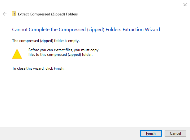

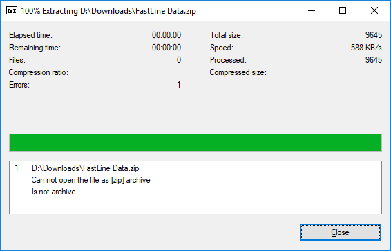

I'm having problems trying to open the zip file here - both 7-Zip and Window's built-in zip extractor give me errors:
could you please generate a new zip file for me and post it here again?

Hello Rob,
that'll teach me to read things more carefully! Thanks for your patience in sending me what I had mistakenly expected.
The answer is the ordering of the XValues - by default they are ordered, so when you add your values in one-by-one they are ordered. Adding in the values directly to the arrays bypasses this. The solution is to set the XValues ordering to None, e.g.
public struct MyStruct
public double Time { get; set; }
public double Velocity { get; set; }
public double Force { get; set; }
FastLine forvel = new FastLine(tChart1.Chart);
var lines = File.ReadAllLines(@"C:\tmp\FastLine Data.csv").Skip(1)
.Select(x => x.Split(','))
.Select(x => x.Select(y => double.Parse(y)))
.Select(x => new MyStruct() { Time = x.ToArray()[0], Velocity = x.ToArray()[1], Force = x.ToArray()[2] }).ToArray();
forvel.XValues.Order = ValueListOrder.None;
for (int count = 0; count < lines.Length; count++)
forvel.Add(lines[count].Velocity, lines[count].Force);
//forvel.Add(lines.Select(x => x.Velocity).ToArray(), lines.Select(y => y.Force).ToArray());
