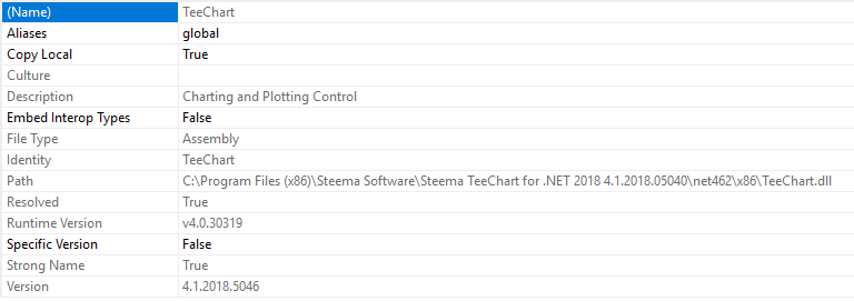

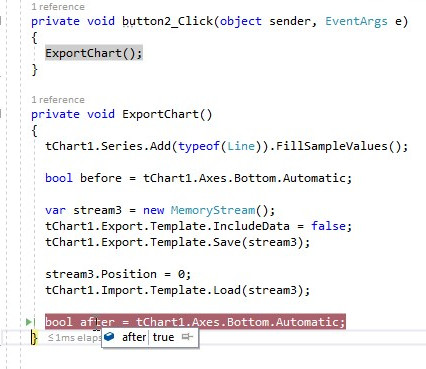

Hello Andy,
using the latest publicly available version of TeeChart.dll (4.1.2018.05040) I cannot reproduce this issue:
which version of TeeChart.dll are you using?

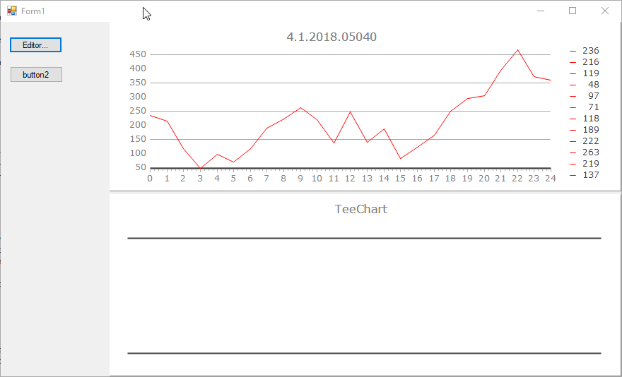

using the following code:
			CreateCharts();
		private TChart tChart1, tChart2;
			FastLine fastLine = new FastLine(tChart1.Chart);
			fastLine.FillSampleValues();
			fastLine.Color = Color.Red;
			MemoryStream stream = new MemoryStream();
			tChart1.Export.Template.Save(stream);
			stream.Position = 0;
			tChart2.Import.Template.Load(stream);
		private void CreateCharts()
			tChart1 = new TChart();
			tChart2 = new TChart();
			tChart2.Dock = DockStyle.Fill;
			tChart1.Header.Text = Utils.Version;
			splitContainer2.Panel1.Controls.Add(tChart1);
			splitContainer2.Panel2.Controls.Add(tChart2);
I obtain the following result:
here the FastLine series color does not seem to be affected by template exportation and importation.
