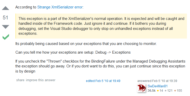

I think you might be getting this error (from here):

The exception will also happen at tun time and will slow down the startup time for the windows forms application.
Please look at the second answer to the above post from stack overflow (copied below)
Use the following method to construct your xmlSerializer instance will fix the problem:
XmlSerializer s = XmlSerializer.FromTypes(new[] { typeof(CustomXMLSerializeObject) })[0];
then, you don't need to turn off the exception handlings.
TChart constructor needs to put above code so that exception does not happen.
The exception slows down the startup of my forms and the above posts mentions that you can generate a XML serializer assembly for TChart DLL that can be distributed. That can also prevent exception.
Please show the post from stack overflow to your developer and see if you can fix the exception and/or generate the serializer assembly.
