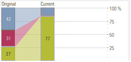

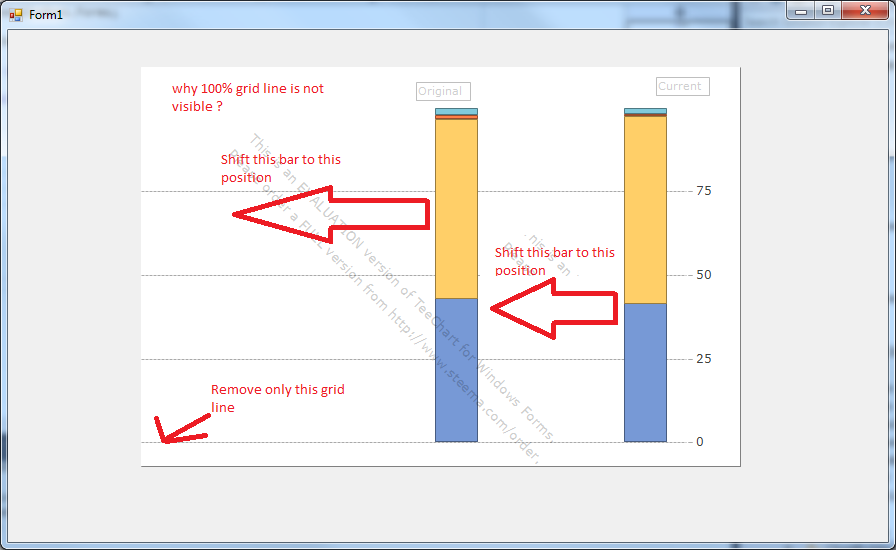

I am trying this using designer only .
1) Is it possible to shift bar graph left ?
2) Can i remove 0 gridline ( bottom most) gridline and show 100% gridline
[img]
Amortization Graph.png (60.84 KiB) Viewed 22423 times
[/img]
Source code : https://github.com/dekajp/DealViewChart ... esigner.cs

Re: Sift 100% Stacked Bar Graph
Post by Christopher » Thu Aug 25, 2016 9:04 am
I think I can achieve what you're looking for with code like the following:
    Form1 form;
    private void button5_Click(object sender, EventArgs e)
      form = new Form1();
      form.tChart1.Axes.Bottom.SetMinMax(1, 2);
      form.tChart1.GetNextAxisLabel += TChart1_GetNextAxisLabel;
      form.ShowDialog();
    private void TChart1_GetNextAxisLabel(object sender, GetNextAxisLabelEventArgs e)
      if (((Steema.TeeChart.Axis)sender).Equals(form.tChart1.Axes.Right)) e.Stop = false;
      switch (e.LabelIndex)
        case 0: e.LabelValue = 25; break;
        case 1: e.LabelValue = 50; break;
        case 2: e.LabelValue = 75; break;
        default: e.Stop = true; break;
rpt
Posts: 24
Joined: Wed Aug 09, 2006 12:00 am
Re: Shift 100% Stacked Bar Graph
Post by rpt » Thu Aug 25, 2016 1:14 pm
thanks chris
This seems to be working . I see that SetMinMax doing the spacing and Event for Axis label is removing 0 value axis line.

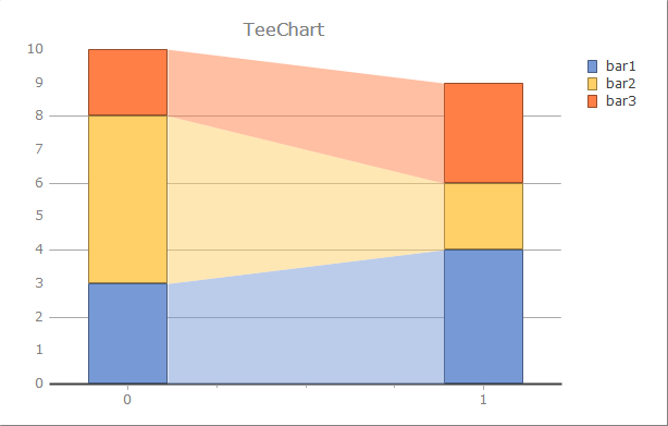

Here's a coded example.
      bar1.MultiBar = MultiBars.Stacked;
      bar1.Add(3);
      bar1.Add(4);
      bar2.Add(5);
      bar2.Add(2);
      bar3.Add(2);
      bar3.Add(3);
      bar1.BarWidthPercent = 30;
      bar2.BarWidthPercent = 30;
      bar3.BarWidthPercent = 30;
    private void tChart2_AfterDraw(object sender, Graphics3D g)
      for (int s = 0; s < tChart2.Series.Count; s++)
        Point[] poly = new Point[4];
        for (int i = 0; i < tChart2.Series[0].Count; i++)
          Bar aBar = ((Bar)tChart2[s]);
            if (i == 0)
              if (s == 0)
                poly[0] = new Point(aBar.CalcXPos(i) + aBar.BarBounds.Width, tChart2.Axes.Bottom.Position);
                poly[0] = new Point(aBar.CalcXPos(i) + aBar.BarBounds.Width, ((Bar)tChart2[s-1]).CalcYPos(i));
              poly[1] = new Point(aBar.CalcXPos(i) + aBar.BarBounds.Width, aBar.CalcYPos(i));
              poly[2] = new Point(aBar.CalcXPos(i), aBar.CalcYPos(i));
              if (s == 0)
                poly[3] = new Point(aBar.CalcXPos(i), tChart2.Axes.Bottom.Position);
                poly[3] = new Point(aBar.CalcXPos(i), ((Bar)tChart2[s - 1]).CalcYPos(i));
          g.Pen.Visible = false;
          g.Brush.Color = aBar.Color;
          g.Brush.Transparency = 50;
        g.ClipRectangle(tChart2.Chart.ChartRect); //don't paint polygon out of bounds on zooms
        g.Polygon(poly);
        g.UnClip();

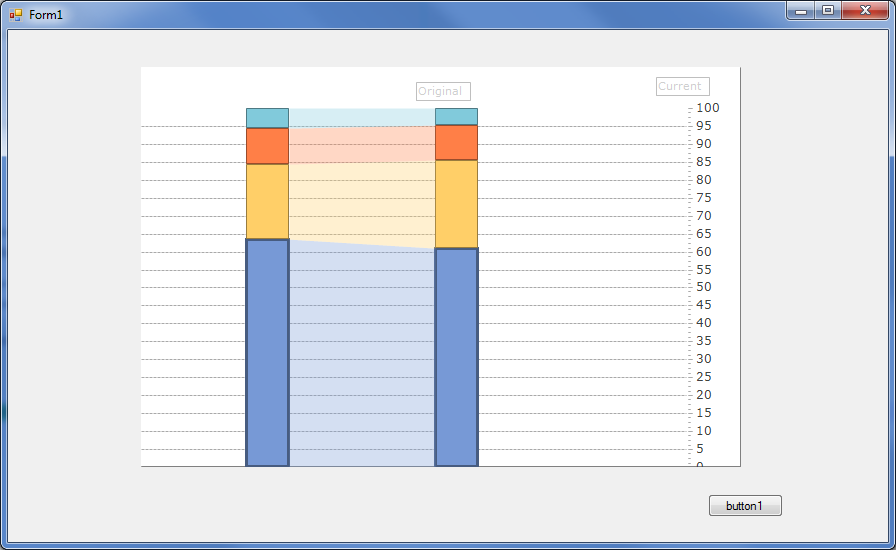

marc
Can you explain me how you got the stacked graph that wide ? Below is my graph and i am using
tChart1.Axes.Bottom.SetMinMax(1,2);
I want to shift Current to right and increase the Gap in between 2 stacks like you have in above post.
Post by Christopher » Mon Jan 09, 2017 11:41 am
rpt wrote: Can you explain me how you got the stacked graph that wide ? Below is my graph and i am using
Are you using the same overload of the Series.Add() method that Marc is using in his code?
