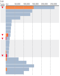

I am trying to achieve this.
I am facing below challenges
1)Can i show a custom y axis as you can see in image little *Red* V icons
2) Also is there a way i can shade gray couple horizontal bars e.g i want to shade alternate 5 bars
This is i am able to achieve.

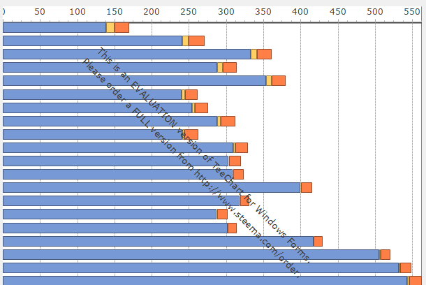

Thanks Chris for your help.
Is there a way i can cover exactly 5 bars by gridband. As of now Gridband start middle of ticks
Also i am not able to get rid of bottom axes and the spaces highligted in Red
Note: Left Axis ticks are temporary

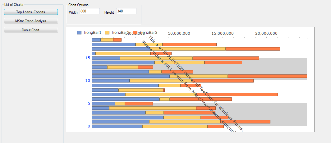

Legend and Chart top is overlapping , Also grid lines are not showing from top axis

Thank you for your code. The problem can be corrected by adding one line to SetCommonProperties():
            tchart.Legend.CustomPosition = true;
            tchart.Legend.Top = 10;
            tchart.Legend.Left = 30;
            tchart.Panel.MarginTop = 10;
The reason the MarginTop is necessary is because you have set CustomPosition to true.

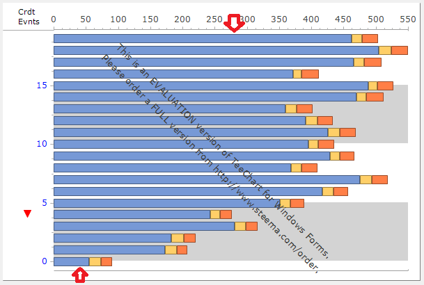

Post by rpt » Tue Aug 23, 2016 6:28 pm
Thank You , this worked
