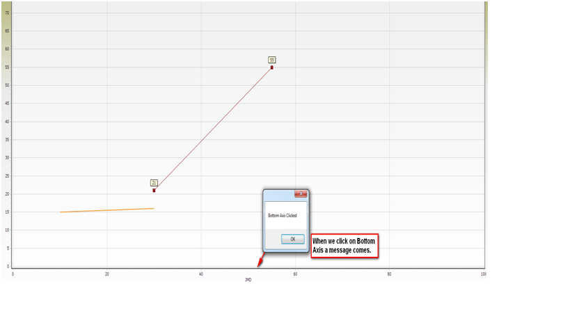

Hi Steema Support,
How can get the event of Axis as shown in fig.
When we click or double click on Bottom Axis it Should raise a Message to showing that Bottom axis clicked .
It will so helpful for us if you please provide any alternative solution.
Thanks and Regards
Planoresearch
Re: Event of Axis
Post by Christopher » Fri Feb 28, 2014 3:47 pm
amol wrote:When we click or double click on Bottom Axis it Should raise a Message to showing that Bottom axis clicked .
Of course. Please try code such as the following:
      tChart1.Series.Add(typeof(Bar)).FillSampleValues();
      tChart1.MouseDown += tChart1_MouseDown;
    void tChart1_MouseDown(object sender, MouseEventArgs e)
      if (tChart1.Axes.Bottom.Clicked(e.X, e.Y))
        tChart1.Zoom.Active = false;
        MessageBox.Show("Bottom axis clicked!");
        tChart1.Zoom.Active = true;
