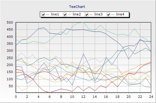

Re: Text overruns Legend bounding box.
Hi Ben,
Back to the issue, I'm not able to reproduce it with v2013 and this code:
which produces this chart:
Can you reproduce the problem with this code? If not, can you please modify it so that we can try to reproduce the problem here?
Yes, thanks. Hope everything is well with you!It's been a long time, since we communicated last, I hope you are doing well!
Current TeeChart for .NET version is version 2013 (aka v4). No code maintenance is being done in v2. However, we can answer to technical inquiries for this version.The file has been uploaded as LegendTextOverrun.zip. We are using a very old version (version 2 ) of the .NET Teechart, and I know you don't support this version, but I'm wondering if that version supported a way to pad the legend width (or some such), so that the text would stay within the legend rectangle?
tChart1.Legend.Alignment = Steema.TeeChart.LegendAlignments.Top;
tChart1.Legend.MaxNumRows = 1;
tChart1.Legend.CheckBoxes = true;
for (int i = 0; i < 12; i++)
tChart1.Series.Add(new Steema.TeeChart.Styles.Line()).FillSampleValues();
Hi Narcis.
Even though your sample code has 12 pens, the legend is only showing 4 pens. Shouldn't it be showing 12 pens? It is important to our customer to be able to see all pens configured on the legend.
