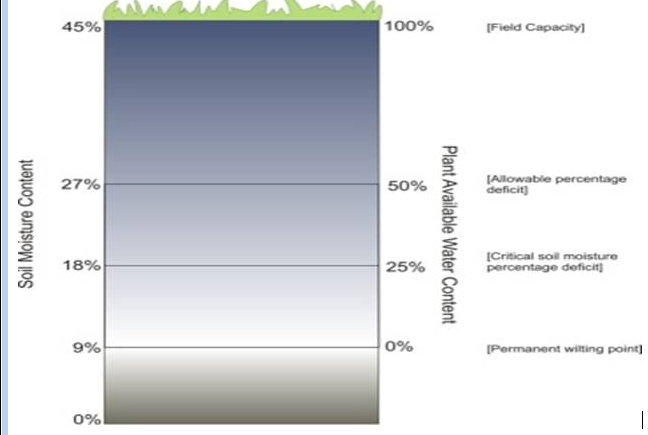

Is it possible to create a self-stacked (single) bar graph with labels off to the side, rather than above each bar. When they're all stacked on top of each other, it makes much more sense to have the label to the side.
I'm trying to generate this graphic, which would ideally have each bar having it's own gradient colour, and a complex label on each side.
If any of the above are possible, please explain how to do it (I'm coding in VB.net). I've tried using the Chart Editor, but couldn't do the above points.
Many thanks,
Phil.

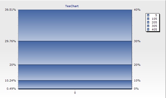

The result image I have gotten is next: .
Could you tell us which version of TeeChartFor.Net are you using? If you use the last version and the problem still appears for you, please send us a simple code because, we can reproduce issue here and try to find a solution for you.
