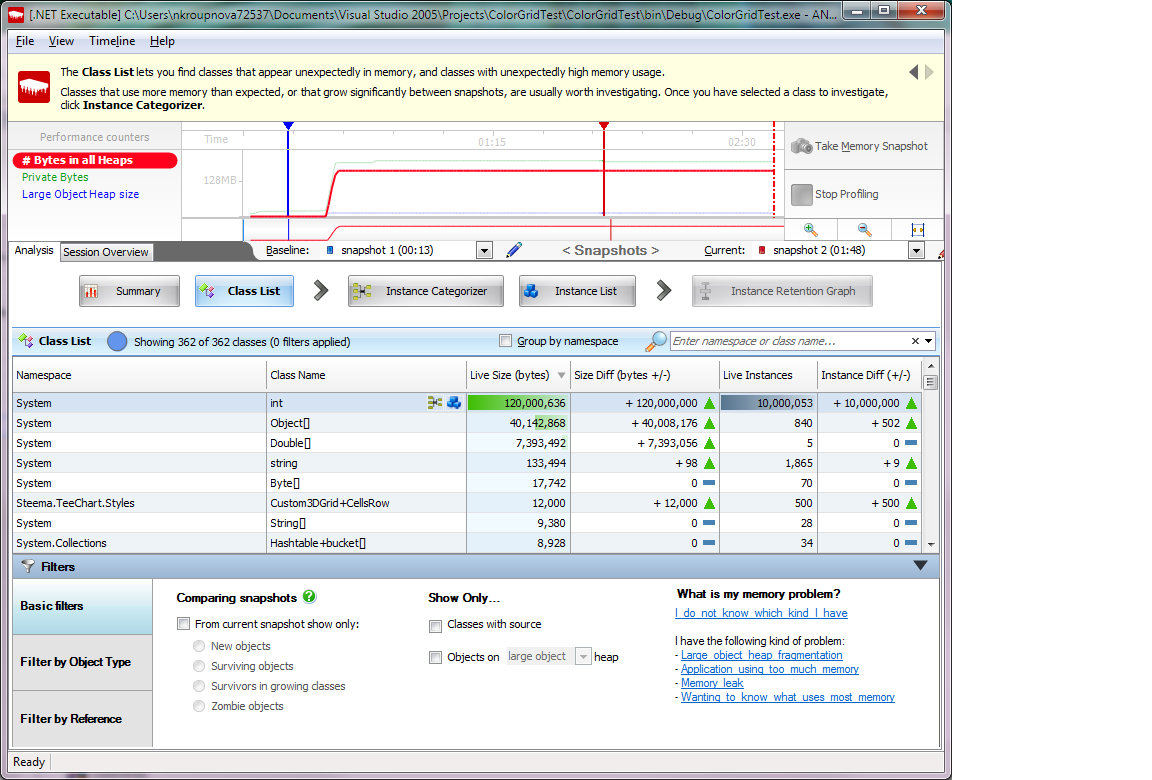

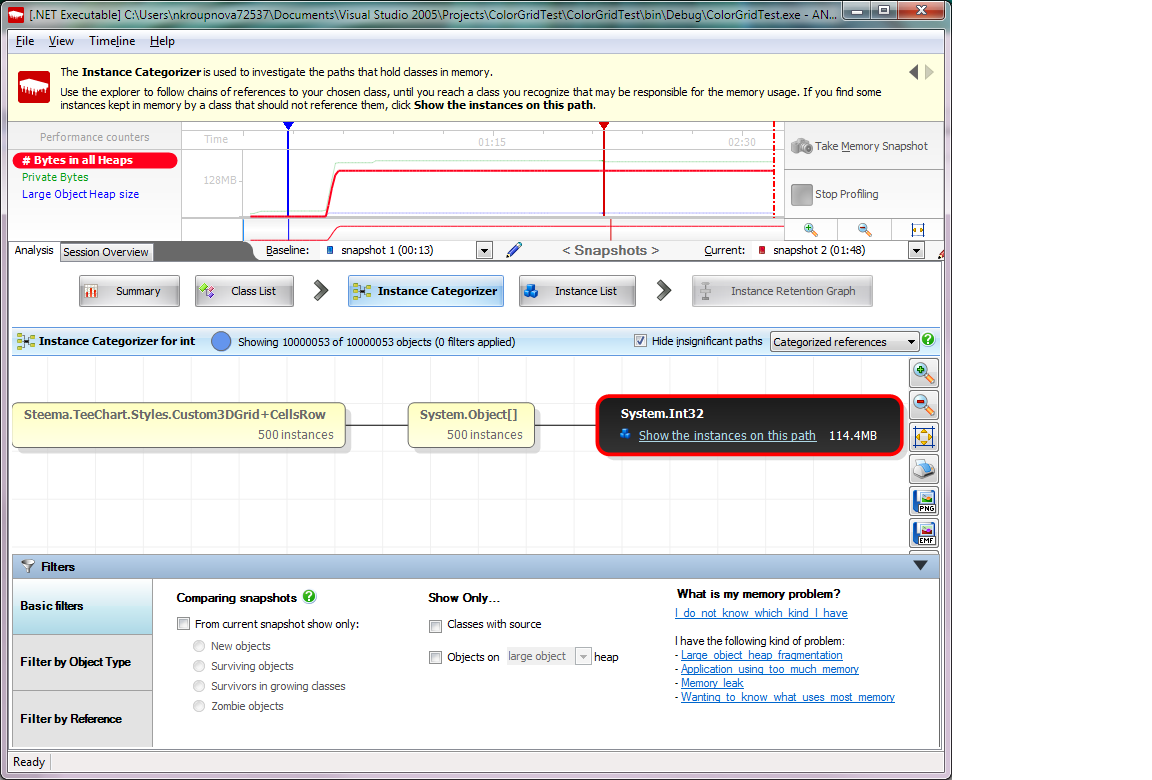

We are using ColorGrid series to display our data. It appears, that the series is allocating a lot of memory. This makes its usage hardly feasible.
I am attaching a test project together with screen shots from the profiler.
What we found, is that TChart is allocating 20000 int per each x value. 500 point chart allocates 10,000,000 instances of int. Plus other objects.
The chart takes up about 155M.
It does not seem to depend on number y or z values.
We need charts of about 1000 points, and several of those (at least 4).

- Profiler screen shot - path
- TestApp_500x10x50_path.png (160.62 KiB) Viewed 8030 times
- TestApp_500x10x50.png (163.2 KiB) Viewed 8027 times
