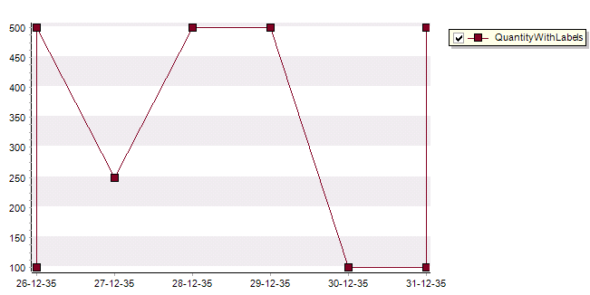

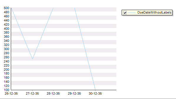

The first screenshot shows the problem. The blue line does not show all the values in the series.
The second screenshot shows the chart when I enabled point markers. It has exactly the same data points, but in this case the entire line is shown.
Any idea what I can do about this?
Marijke.
this is the same data but with point markers enabled
illustrates the problem in my line series

apparently, when posting the topic, the screenshots are twisted.
So, what I mean is that
- when point markers are not shown (in the chart with the blue line) part of the line is missing. when the line touches the boundaries of the chart section.
- when there are point markers shown, the entire line is shown as it should (in the chart with the red line).
I hope that my explanation is a bit clear.

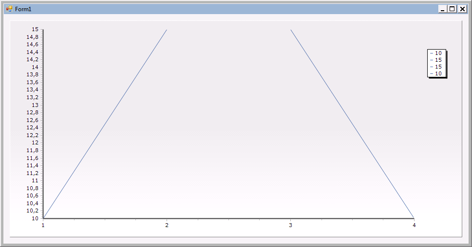

Here is a simple class where I can reproduce the problem
using System;
using System.Linq;
using System.Text;
using Steema.TeeChart;
namespace TeeChartTest
    class ChartTester
        private TChart chut; // chart under test
        private Steema.TeeChart.Styles.Line line;
        public ChartTester(TChart chartToTest)
            chut = chartToTest;
            ConfigChart();
            AddTestData();
        public void ConfigChart()
            chut.Axes.Left.Grid.Visible = false;
            chut.Axes.Bottom.Grid.Visible = false;
            chut.Walls.Back.Visible = false;
            chut.Header.Visible = false;
        public void AddTestData()
            chut.Aspect.View3D = false;
            line = new Steema.TeeChart.Styles.Line(chut.Chart);
            line.Add(1, 10);
            line.Add(2, 15);
            line.Add(3, 15);
            line.Add(4, 10);
The result of this class shows the chart in the attachment of this post.

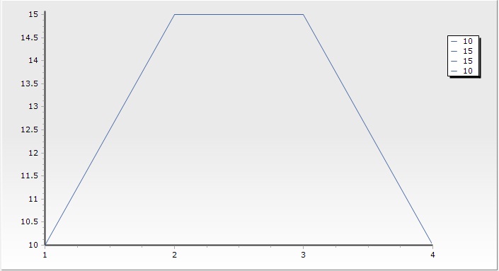

Re: Line Series not shown when values at borders of the chart
Post by Sandra » Thu Jun 07, 2012 3:03 pm
Hello MVB,
Ok, in this case I suggest you change the MaximumOffset of left axis to achieve show all of series as I do in next lines of code:
            line = new Steema.TeeChart.Styles.Line(tChart1.Chart);
            line.Add(1, 10);
            line.Add(2, 15);
            line.Add(3, 15);
            line.Add(4, 10);
            tChart1.Axes.Left.MaximumOffset = 5;
Can you tell us if previous code works as you expect?

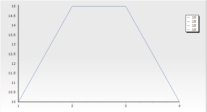

I get next result:
If I use your code setting the tChart1.Axes.Left.AutomaticMaximum to true:
            //Chart
            tChart1.Axes.Left.Grid.Visible = false;
            tChart1.Axes.Left.AutomaticMaximum = true;
            tChart1.Axes.Left.Maximum = 15;
            tChart1.Axes.Bottom.Grid.Visible = false;
            tChart1.Walls.Back.Visible = false;
            tChart1.Header.Visible = false;
            //Series
            line.Add(1, 10);
            line.Add(2, 15);
            line.Add(3, 15);
            line.Add(4, 10);
I get next result:
As you see I have gotten the same result, independently if I set true or false the AutomaticMaximum of Axis. For this reason, if you can attach me your project so we can try to find where is the problem. On the other hand, you need know, if you want work with automatic axes is not necessary use next lines of code, so to default TChart use automatic values in Axes:
