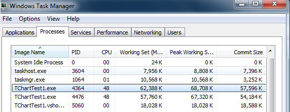

Re: Memory Usage keep increasing when auto scrolling chart
Hi Sandra,
I installed v4.1.2012.01030 and rebuild my test app.
My test machine is running Windows 7, 32 bit.
I launch the test app and choose "2 Series". I click Start. At this time the memory shown in the Task Manager (Working Set Memory), it shows 30Mb.
1 Hour later, it shows 41Mb.
2 Hour later, it shows 60Mb.
I have attached the screen capture of the Task Manager.
(In this screen capture, I have 2 instance of the test app, one running "2 Series", another running "30 Series".)
- TChartTest-Memory-2Hr.png (37.45 KiB) Viewed 15804 times

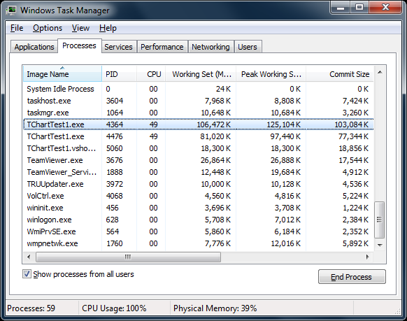

Hi Sandra,
Here is another screen capture after running for 4 hours.
- TChartTest-Memory-4Hr.png (54.8 KiB) Viewed 15723 times

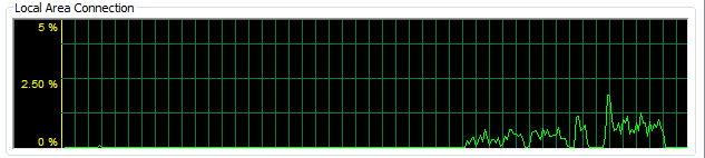

Hi Sandra,
I have modified my test application to add another Timer. This timer will be fired once every 5 seconds.
In the timer handler, I do a "GC.Collect()".
I run the test application again for 1 hour. I still see the memory keep increasing. So it seems that "GC.Collect()" does not help.
In my test application, I have an option to use 2 series or 30 series.
I noticed that the one using 2 series is using more memory then the 30 series.
Each series keep the last 1000 data point. I would expect the one using 30 series uses more memory, if we think that the memory is taken by the data points.
But it seems we may be hunting in the wrong path.
Rather then figuring out why the memory keep increasing, I would like you to propose what is the best way to use teechart to do the following.
1. A line chart with several series.
2. Each series start or data arrival may be at different time.
3. The X axis to display the time.
4. The chart should auto scroll to show the latest data point.
5. Keep the last 1000 data point for each series.
I believe the above requirement is very normal. Open a Task Manager and click the Networking tab and you can see such a line chart (of the network traffic).
This line chart will auto scroll and is time based and has several lines per chart. (See Attached Image)
Using your professional knowledge of the correct way of using TeeChart, can you give me a sample application to show me the correct way to do what is shown in the Task Manager's chart?
- TaskManagerNetworking.png (4.59 KiB) Viewed 15657 times

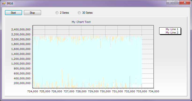

Hi Narcis,
Thanks for the sample. I have created a new test app using the given sample.
However, the X asis does not display as the elapsed time format.
Can you update the code such that the X asis shows in time format? (Elapsed time)
- TChartTest2.png (46.17 KiB) Viewed 15648 times
