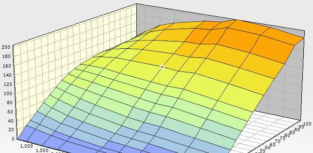

hello dear teechart team,
i have a question of teechart surface serial as following scenario:
when i click on the surface, i want to highlight the nearest cross-point at the mouse position, i want to use a white circle to mark this cross point and show x/y/z value of the point, how can i realize it? I know the surfacenearest tool may be a choise, but i do not want to mark a cell, only the cross-point.
Posts: 9715
Re: How to hightlight cross point in surface serial?
Post by Yeray » Mon Sep 05, 2011 10:38 am
I'm afraid this should be done manually. Here it is, as a start point, an example of how to draw the four points of the clicked cell.
From here, you have to calculate which one of those points is the nearest to the mouse position.
