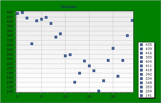

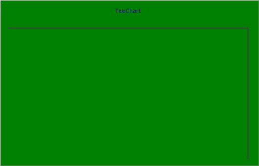

You need know that Walls Right, for default isn't visible, so property Walls work fine as you can see i next image, where I have changed the color of Chart Panel and I have set the walls as not visible:
Image Walls.Visible=true:
Image Walls.Visible=false:
To genereted this image I have use next code:
Private ChartController1 As Steema.TeeChart.ChartController

	tChart1.Series.Clear()
	tChart1.Axes.Left.Visible = False
	tChart1.Axes.Bottom.Visible = False
	tChart1.Walls.Visible = False
End Sub
Please check previous code if works as you expected? If isn't work as you want please explain exactly why you think that walls are visible so we can try to help you to solve it.

If you can need set axes property visible = false as do in following line of code:
    tChart1.Axes.Visible = false;
Can you tell us if previous line of code works as you want?

Hmmm...Yes it works and it means the right and top lines left, are part of Axis not walls.
