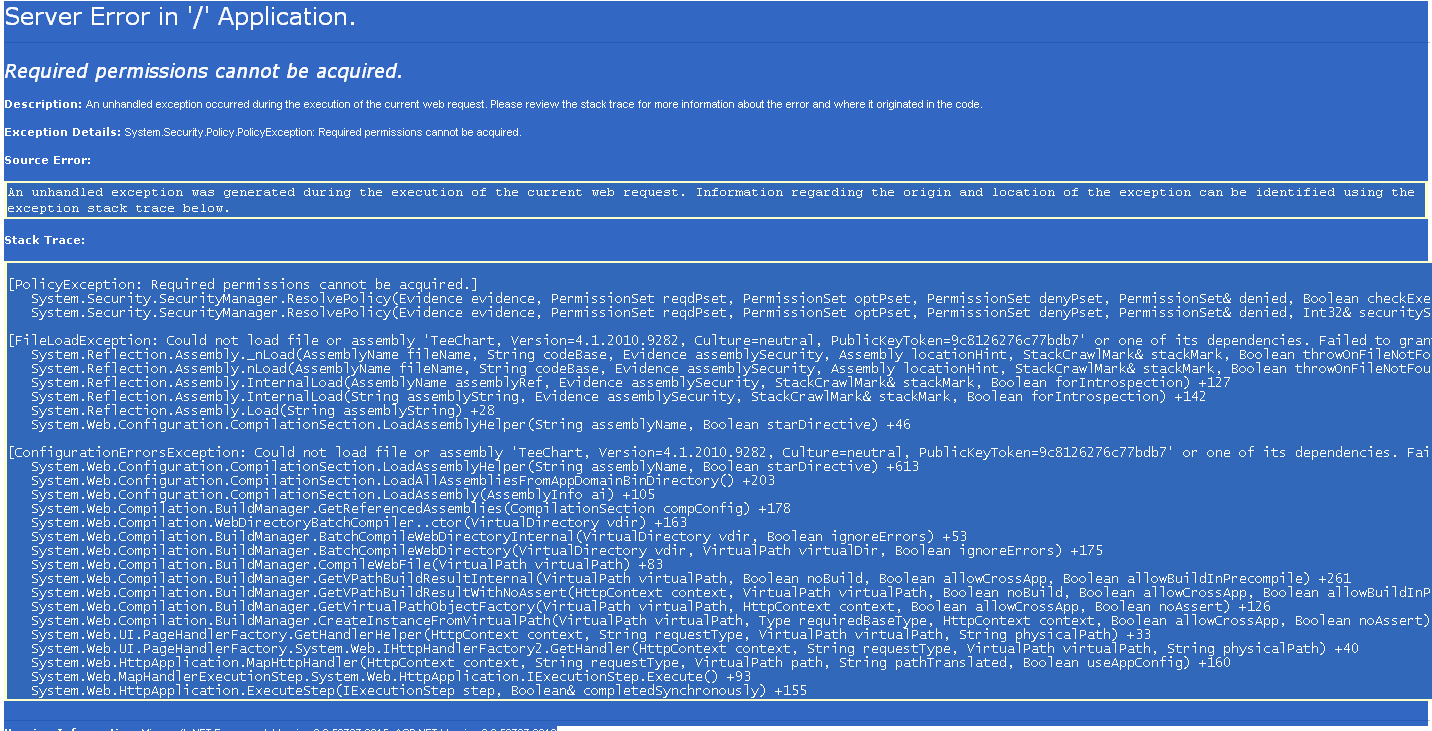

Your app failed as well. Same fault as my app. However last night after battling a bit with example of Webchart I got the example working and therefore it is not the server that is at fault here. So the question is why does a new web chart fail when published to this website and the example works?
Please see fault attached. If you guys require some credentials to publish to this site please let me know so you can test. I have currently finished my app using MSChart however MSChart at the moment doesn't cater for the options that TeeChart has and I also would like to use gauges in my chart which currently I can't see how MSChart would do that. Only started using MSChart yesterday though. I also want to extend my license as it expires at end of this month and this is the only thing holding me back now.

- fault generated from your website.
- WAZSite1.png (98.13 KiB) Viewed 19282 times

Hi Waz,
The error message "required permissions cannot be aquired" seems to imply that the security level of the IIS application is not sufficient for the elements included in the application, in this case TeeChart. We published the test app here locally and then copied the folder to a remote server and added a new IIS Application to the folder location. The project worked successfully first. Point to note is that the default security for the share on that machine is 'full'. Editing those permissions down to 'high' or 'medium' would cause a failure with a similar error message to the one you quote.
To check that go to '.NET Trust Levels' of your IIS share and move the security up to 'Full'.
