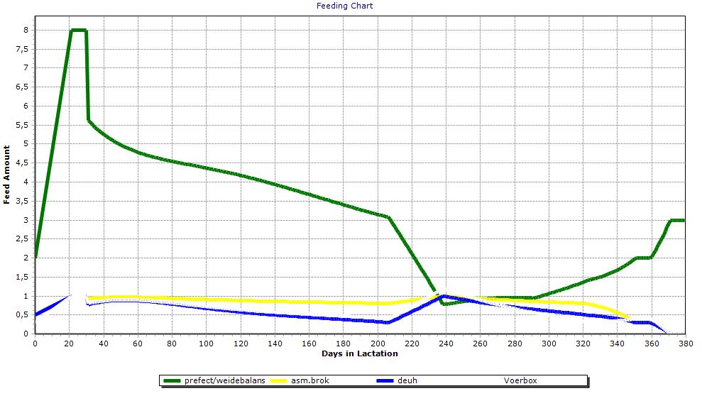

Hello i want to draw in my Graph four lines different color.when i write code, which is belove ,four lines look different color then i wrote as shown in picture.Especially white color looks very bad.Please could you help ,how i can draw different color lines?
Line newLine = new Line();
newLine.LinePen.Width = 5;
series = newLine;
series[0].Color = Color.Red;
series[1].Color = Color.Purple;
series[2].Color = Color.Black;
series[3].Color = Color.Yellow;

I tried the code which you wrote.But it gives error.Error is "System.ArgumentOutOfRangeException: Index was out of range. Must be non-negative and less than the size of the collection"
