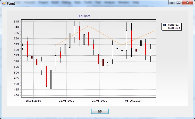

1st:
number of point should not be multiple of period! It's abcolutelly incorrect requirement for input seria!
You can find definition of Standard Deviation in Wiki: http://en.wikipedia.org/wiki/Standard_d ... the_sample
Each point of function should be calculate, based on N points of base seria. It is similar with , e.g., MA calculation.
2nd:
here is the code with func.PeriodStyle = Steema.TeeChart.Functions.PeriodStyles.Range;
Steema.TeeChart.Styles.Candle candle = new Steema.TeeChart.Styles.Candle(tChart1.Chart);
            Steema.TeeChart.Functions.High func = new Steema.TeeChart.Functions.High();
            func.Period = 7;
            func.PeriodAlign = Steema.TeeChart.Functions.PeriodAligns.Last;
            candle.FillSampleValues((int)(28));
            Steema.TeeChart.Styles.FastLine line = new Steema.TeeChart.Styles.FastLine(tChart1.Chart);
            line.DataSource = candle;
            line.Function = func;
and note, number of values is multiple with period! it is incorrect requirement, but it's not working anyway! I see only points of function for each N point of seria - only 4 points for 28 points seria!!!

Hi luzhetsky,
This is not a requirement. This was just my suggestion if you wanted the function to be aligned with last point in source series.
That's what the PeriodStyle property does. Have you read Steema.TeeChart.Functions.Function.PeriodStyle entry in the help file?
Yes, exactly, that's what Period property does. As you can see in the help file for Steema.TeeChart.Functions.Function.Period:
The Period property controls how many points or X range will trigger a new point calculation.
For example, TAverageTeeFunction uses the Period property to calculate a new average point each time the "Period" number of points or X range is exceed.
NOTE:You may switch between number of points or X range by using the TTeeFunction.PeriodStyle property.

Narcís,
you should notice that in both type of PeriodStyle StD, High, Low functions calculate with the same manner: on each N points only.
Any Techical Analisis tool need caclulation for EACH point: each point data is based on calculation of previous N.
Only this we need.
Current implementation is wrong!
And we are expecting the answer from TeeChart team how to resolve existing problem of implementation of StD and High and Low functions?
Thank you.
Try using this code:
      FastLine line = new FastLine(tChart1.Chart);
      line.FillSampleValues(30);
      FastLine func = new FastLine(tChart1.Chart);
      High high = new High();
      high.Period = 10;
      high.PeriodAlign = PeriodAligns.Last;
      func.Function = high;
      func.DataSource = line;
Now put a break point in the Calculate method of the Steema.TeeChart.Functions.High function in Basic.cs. You'll see sources series' first ten points are used in the calculation, as firstIndex = 0 and lastIndex = 9, and the result is plotted and so forth: firstIndex = 10 and lastIndex = 19 and finally firstIndex = 20 and lastIndex = 29.
In the code above, we define N as 10 (Period = 10). TeeChart calculates the highest value for the points of index 0 to 9 and plots it. It then calculates the highest value for the points of index 10 to 19 and plots it and so on. So, as stated, the present High function is already doing the calculation on each point. Every single point in the source series is involved in the calculation. Therefore the High function plots a point based on the calculation of the previous N points.
Also notice the same applies to StdDeviation function.
If that's not what you meant, could you please elaborate on that?
