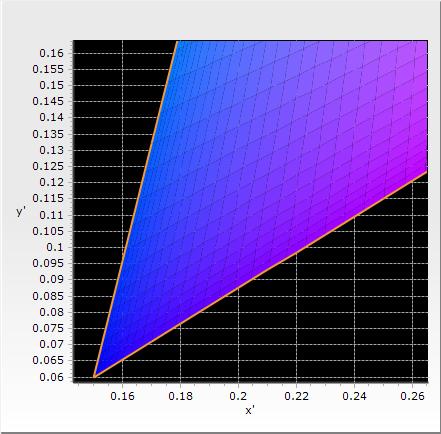

I'm working on a chart that contains both Map and Line series. I'm trying to turn off any boundaries between the polygons in the map, and have had some success by setting
map1.Pen.Visible = false;
tChart1.Aspect.SmoothingMode = SmoothingMode.HighSpeed;
The resulting plot looks good, but I don't like the jagged look of the border Line:
When I change the SmoothingMode to HighQuality or AntiAlias the orange outline looks better but the boundaries of the polygons appear, and I don't want those to show up:
Is it possible to set the smoothing modes of the series individually, or otherwise to get the smoothed outline without the polygon borders?
Thank you very much!
Bob

Post by Yeray » Mon Feb 01, 2010 3:54 pm
Hi Bob,
I've been able to reproduce the issue here with the following code so I've added it to the wish list to be improved in future releases (TF02014662).
