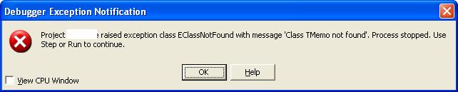

when saving a chart to stream im using the following code:
SaveChartToStream(Chart1,strm,TRUE,TRUE);
strm : TMemoryStream;
when loading it back im using the following code:
LoadChartFromStream(TCustomChart(Chart1),strm);
i have to typecast to TCustomChart or else it wont compile
when the code is executed i get the attached error.
the error is internal and is visible only when running in debug mode, running it from outside of delphi nothing is shown to the user.
anyway, the loading is successful as if nothing happened
please advice

Hi Nati,
The following example seems to work fine here:
uses teestore, series;
  Chart1.RemoveAllSeries;
procedure TForm1.Button2Click(Sender: TObject);
  strm.Position := 0;
  strm := TMemoryStream.Create;
  Chart1.AddSeries(TPointSeries.Create(self));
  Chart1[0].FillSampleValues(25);
Could you please modify it or attach here a simple example project we can run as-is to reproduce the problem here?
