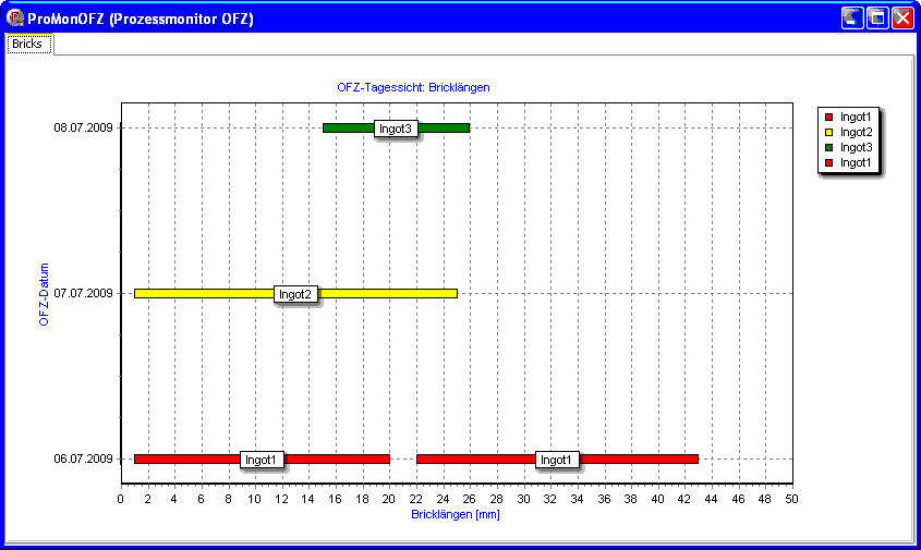

I managed to program the Gantt-Chart you find in the attached picture. I used the following code:
    Series_Gantt_Bricks.AddGanttColor(1,20,40000,'Ingot1',clred);
    Series_Gantt_Bricks.AddGanttColor(22,43,40000,'Ingot1',clred);
    Series_Gantt_Bricks.AddGanttColor(1,25,40001,'Ingot2',clyellow);
    Series_Gantt_Bricks.AddGanttColor(15,26,40002,'Ingot3',clgreen);
(Note: I switched the vertical axis to datetime. Therefore the 40000... values are shown as dates.)
My question: The legend shows 'Ingot1' twice. How can I manage that my legend only adds one entry for each label - no matter how often it appears as a gantt-bar. For examble: Only three entrys (Ingot1, Ingot2, Ingot3) in my example?
Is there a way? Any ideas?
Heiko
Simplified Gantt-Chart demonstrates question

Post by Yeray » Wed Jul 01, 2009 8:15 am
Hi Heiko,
I'm afraid that this is not easy to do as the actual legend draws an item for each point (having LegendStyle as lsValues). I want you to know that there is already in the wish list, the possibility to fully customize the legend item by item. But while it's not implemented, I'm afraid that the only I can think is custom drawing text and rectangles to the canvas.
