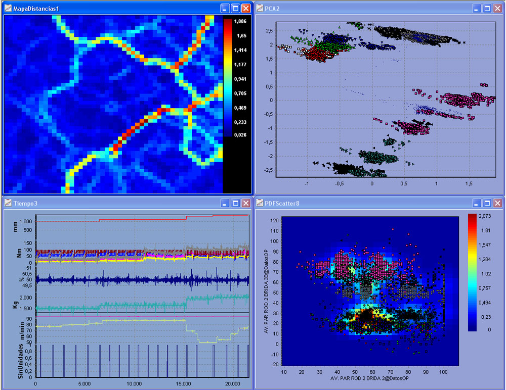

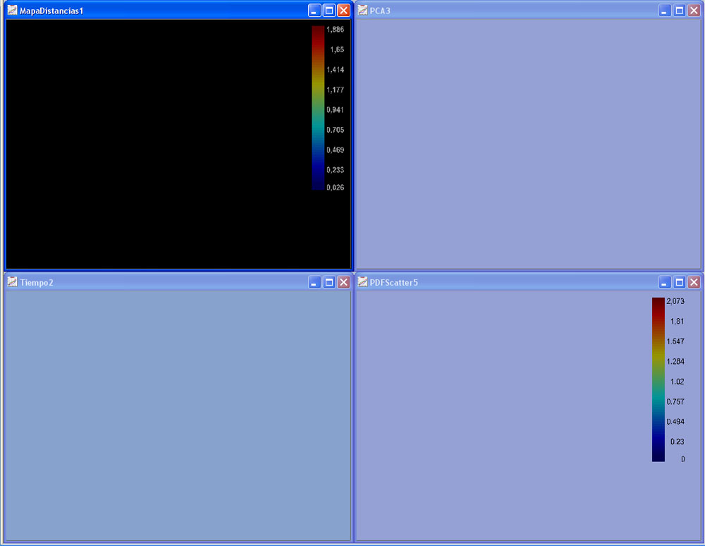

I uploaded two images for you to see how I currently see 4 of my graphs and how I see them using TeeOpenGL. As you may see, 2D series are not shown using TeeOpenGL, so I can't tell differences.
Anyways, I'm trying to enhance my source code and I have one question: How could I know the drawn points number of a series when the event OnGetPointerStyle is triggered? I mean, the forthcoming visible points number. Since this event is triggered before OnBeforeDrawAxes (and before OnBeforeChartDraw), if I just zoomed, I can't figure out how to know that.

Maybe you should consider using AntiAlias Tool instead of OpenGL since it wasn't thought to be used with 2D.
On the other hand, I still think that the first problem is that activating OpenGL, the chart is moved and zoomed. So, if you still want to use OpenGL, you should try to find the correct zoom, HorizontalOffset, etc... values for your charts like in the following example (I recommend you to use a TeeCommander to find the values easily):
