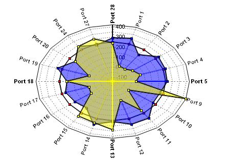

A new problem. When I use the Anti-Alias in my Radar PLot, for some reason the PEN of my RadarSeries becomes Black.
I would like to keep the currnt color of the Pen.
Ricarod Abech

RPABECH
Posts: 6
Joined: Thu Dec 06, 2007 12:00 am
Re: Radar Chart issue with Let Axis Minimum
Post by RPABECH » Thu Jun 25, 2009 3:54 pm
HI,
Yes, the Anti-Alias works. But my Pen Color gets changed to Black for all series. I really need them to keep their colors.
See attached file.
Best regards,
Ricardo Abech
Post by Yeray » Fri Jun 26, 2009 9:29 am
Hi Ricardo,
Now I could reproduce it. The problem seems to be with the combination AntiAlias Tool + Rose Series Pen Width greater than 1. I've added it to the wish list to be fixed in future releases (TV52014265).
uses TeeAntiAlias, Series, TeePolar;
  Chart1.View3D := false;
  Chart1.Tools.Add(TAntiAliasTool.Create(self));
  Chart1.AddSeries(TRadarSeries.Create(self));
  Chart1[0].FillSampleValues(10);
  Chart1[0].Pen.Width := 2;
RPABECH
Posts: 6
Post by RPABECH » Fri Jun 26, 2009 12:08 pm
Yes. That works fine for PEN Width = 1. But if I increase that to 2 or more (I use 3), then The pen turns Black.
Do you see this same behaviour?
Ricardo Abech
Post by Yeray » Fri Jun 26, 2009 1:27 pm
Hi Ricardo,
Yes, that's the bug I've added to the list.
