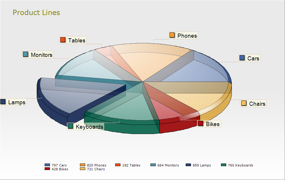

I found this very nice looking pie chart in the Gallery on your website:
I did not found this as an example shipping with TeeChart V8.04.
Can you please tell me if such a chart can be build with TeeChart in Delphi 2007?

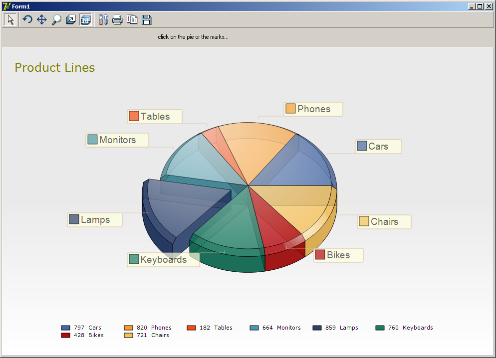

Post by Yeray » Wed Aug 18, 2010 3:00 pm
I've upgraded the Pie in the post above to TeeChart v2010 and its new properties: BevelPercent, EdgeStyle and Transparency.
The result is quite better:
And here you have the source code and the executable:
