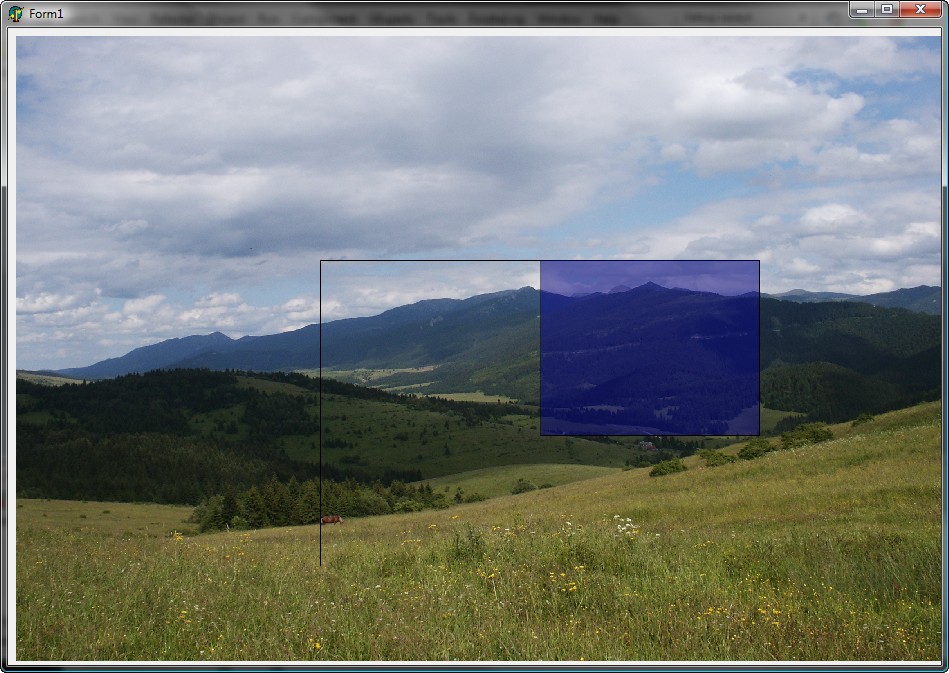

Post by dave555 » Thu Jul 30, 2009 3:41 pm
Hello Narcis
Thank you for sending me the project. When I run it, I get the result shown in the attached image - definitely not showing a map series with transparent chart background. I am using Delphi 2009 with Vista. Any help would be appreciated.
David
Re: Transparent Background
Post by Yeray » Fri Jul 31, 2009 8:49 am
Hi David,
I'm not sure to understand what you mean. I see a map series, and I see the image behind the chart. Could you please explain what you are exactly trying to achieve?
On the other hand, as this new forum allows us to attach files, here is the project for whoever wants it.
Post by dave555 » Sat Aug 01, 2009 1:51 pm
Hi Narcis
You are quite right; the demo project does work correctly.
I am saving files in PNG, TIFF and GIF formats. My hope is that in those saved images the chart background could be transparent.
David
Post by Yeray » Mon Aug 03, 2009 8:45 am
Hi David,
I'm afraid that exporting to bitmaps charts with transparency is a known problem already in the wish list to be fixed in further releases.
