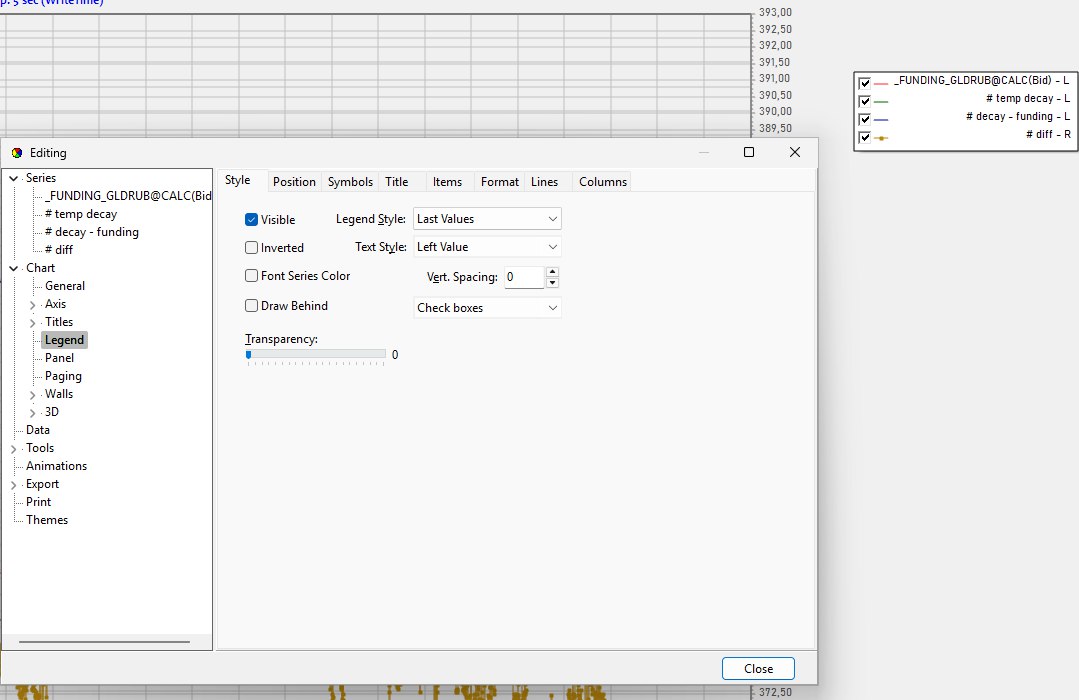

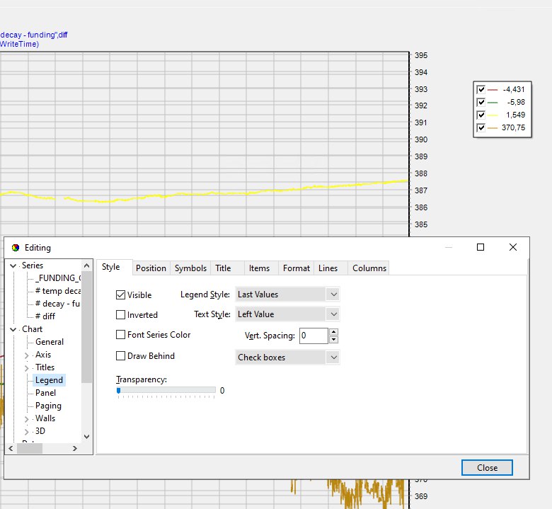

Since last release (2025.44.250520) Legend.Style=lsLastValues does not work properly.
Please see minimal example in attachment...
old version:
new version:

Yes, that was bug in v2025.44, which was identified and fixed here.
Find below the full git diff:
