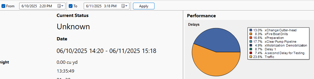

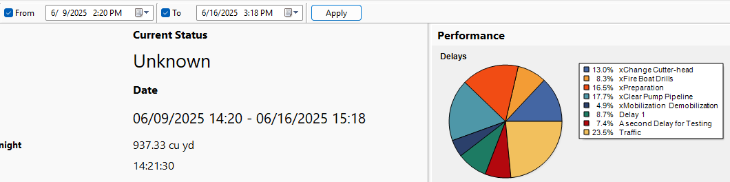

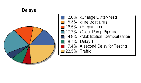

I am using a Pie Chart and when I send some data to it the first time, it is great. It looks like:
However, when I try to limit the data, the legend entries all stay. I call the Clear function on the series, then run the data again with fewer entries and get:

Posts: 9712
Re: Pie Chart Legend bug or my missing call?
Post by Yeray » Tue Jun 17, 2025 2:49 pm
Hello John,
I've seen the fix for #1210 in TeeChart v2025.44 breaks this.
We are revising it.

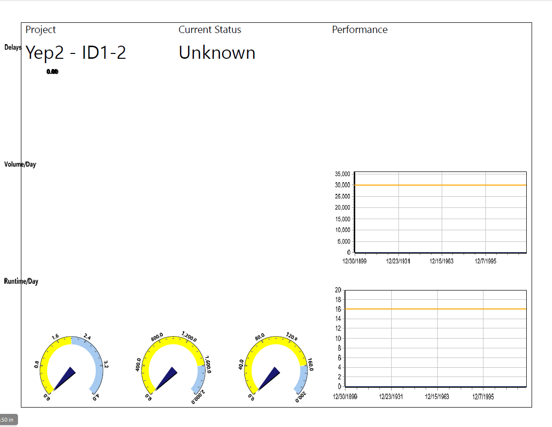

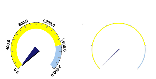

I think I have identified another small bug. Using PrintPartialCanvas, the chart titles don't seem to adjust to the given rectangle:
I was going to go tinkering around in the code, but figured I would point it out anyway.
John

Plus, what does PrintProportional do? It says it is on by default, but the charts seem to stretch if I don't set the right aspect ratio. The circular gauges ignore the Circled property.
Thanks again...

I figured maybe I could get around it by drawing to a Bitmap, then painting that to the printer. I got this:
John
Posts: 9712
Post by Yeray » Tue Jun 17, 2025 8:12 pm
Hello John,
We are revising it.
I came up with this fix:

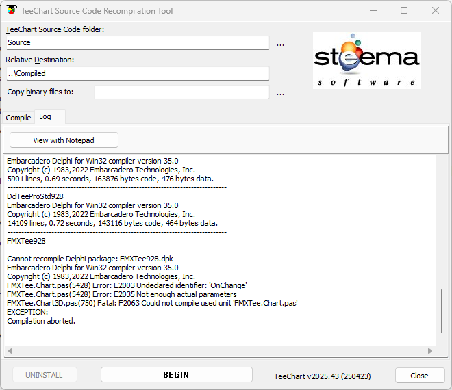

Hello, I am getting a compile error with those changes:

Post by Yeray » Wed Jun 18, 2025 8:29 am
Hello John,
Sorry. This is the fix for that error:
--- a/Chart.pas
+++ b/Chart.pas
@@ -5523,6 +5523,9 @@ end;
 procedure TLegendItem.FontChanged(Sender: TObject);
   SetCustom(False);
+  if Assigned(ILegend) then
+    ILegend.CanvasChanged(Sender);
 function TLegendItem.GetFont:TTeeFont;
@@ -5542,7 +5545,12 @@ begin
         FFont:=TTeeFont.Create(nil);
+  {$IFDEF FMX}
+  FFont.Brush.OnChanged:=FontChanged;
+  {$ELSE}
   FFont.OnChange:=FontChanged;
+  {$ENDIF}
   result:=FFont;

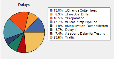

Post by JNuzzi » Wed Jun 18, 2025 1:41 pm
Hello Yeray,
Thank you. It compiles now, and the legends work as intended.

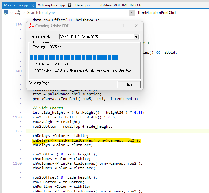

I have another new issue (besides titles and stretching during printing), now it just stops when printing the charts (or takes a really long time...not sure):

It did eventually print after a few minutes.
Posts: 9712
Post by Yeray » Wed Jun 18, 2025 3:15 pm
I'm not sure to understand the problems you are experiencing with printing.

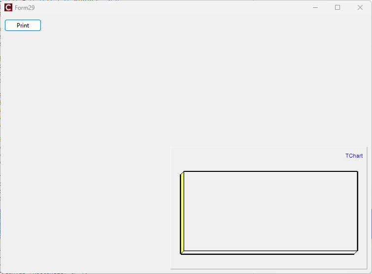

Post by JNuzzi » Wed Jun 18, 2025 4:34 pm

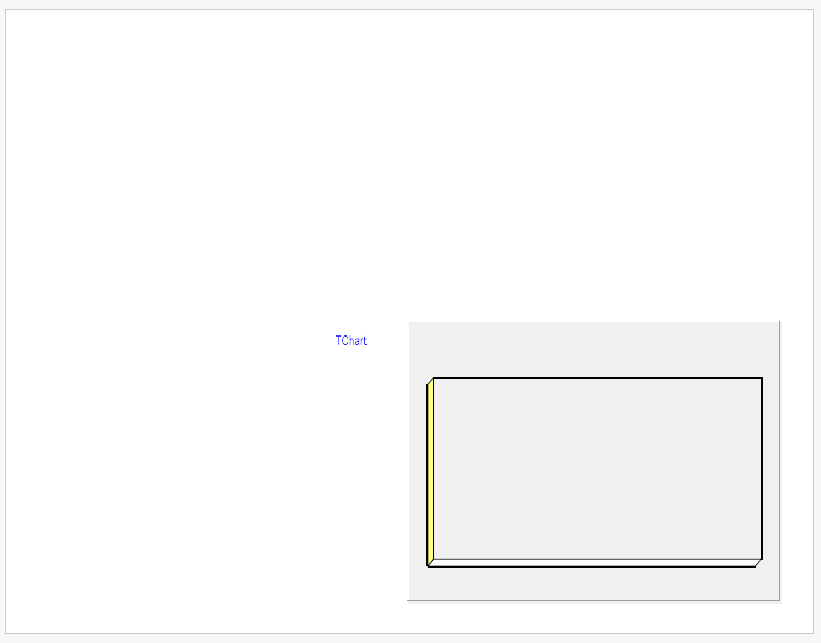

Sure. Here is a quick little program:
(btw, the title was set to left justified alignment)
Here is a PDF print of that:
The Sample Project Zip is attached.
It's giving me all types of hell. I just compiled a Release version and lost the center alignment on the circular gauges. it works with Debug still, though.
John
SamplePrintError.zip
(9.96 KiB) Downloaded 234 times

It seems like using anything but the default center alignment for the title does odd stuff.
