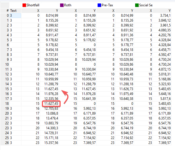

Post by Yeray » Fri Apr 11, 2025 11:06 am
Looking at the final data in the series I see at the index 18, instead of reusing the preceding value (index 17), it takes the value of a couple of indices above (index 15):
If you debug the final lChartStepDowns loop, where you add the repeated values, you'll see you are getting the stepDowns for values 8, 5 and 15, in that order.
- Adding a repeated value for the 8 affects the indexes >8. Ok.
- Adding a repeated value for the 5 affects the indexes >5. The operation above didn't affect this. Ok.
- Adding a repeated value for the 15 affects the indexes >15. The operations above affect this because now at the index 15 you have the XValue 13 and YValue 11.627.45.
To fix this, you only have to sort the lChartStepDowns before the loop so you add repeated loops from the end:
uses Generics.Defaults;
var IntegerComparer: IComparer<Integer>;
function CompareStepDowns(const ALeft, ARight: TChartStepDown): Integer;
  Result:=IntegerComparer.Compare(ALeft.FX, ARight.FX);
procedure TForm2.UpdateChart(aChart: TChart);
var
  Comparer: IComparer<TChartStepDown>;
    Comparer:=TComparer<TChartStepDown>.Construct(CompareStepDowns);
    lChartStepDowns.Sort(Comparer);
    for I := lChartStepDowns.Count-1 downto 0 do begin
      lChartStepDown := lChartStepDowns[I];

Post by Ed Dressel » Fri Apr 11, 2025 2:09 pm
Thank you! That works perfectly.
