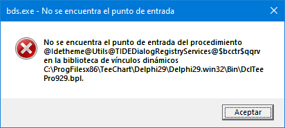

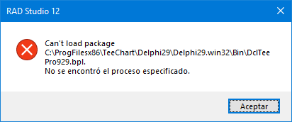

After installing the new version of teechart, when opening RadStudio the packages does not load.
All the packages shown the same behaviour as the images attached.
I unistalled old version and I install the new one but the error persist.
Any idea?
Posts: 9712
Re: TeeChartVCLFMX-2024.41 does not load in the RADSTUDIO 12.1 patch 1 IDE
Post by Yeray » Wed Sep 18, 2024 1:31 pm
The TeeChart v2024.41 binary release was built with RAD Studio 12.2.
Please update your RAD Studio if possible.
If you can't update it, you can use TeeChart v2024.41 with sources version to compile it with your RAD Studio 12.1.
Alternatively, you can continue using TeeChart binary v2024.40 with RAD Studio 12.1.
