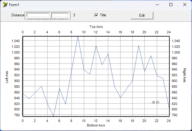

We are working on a new Distance property.
This is how it looks for now:
Note in that trackbar I'm setting all 4 axes at once, but that's property is per-axis.
I'm afraid that property won't get into the build we are preparing to support the new RAD 12.2.
