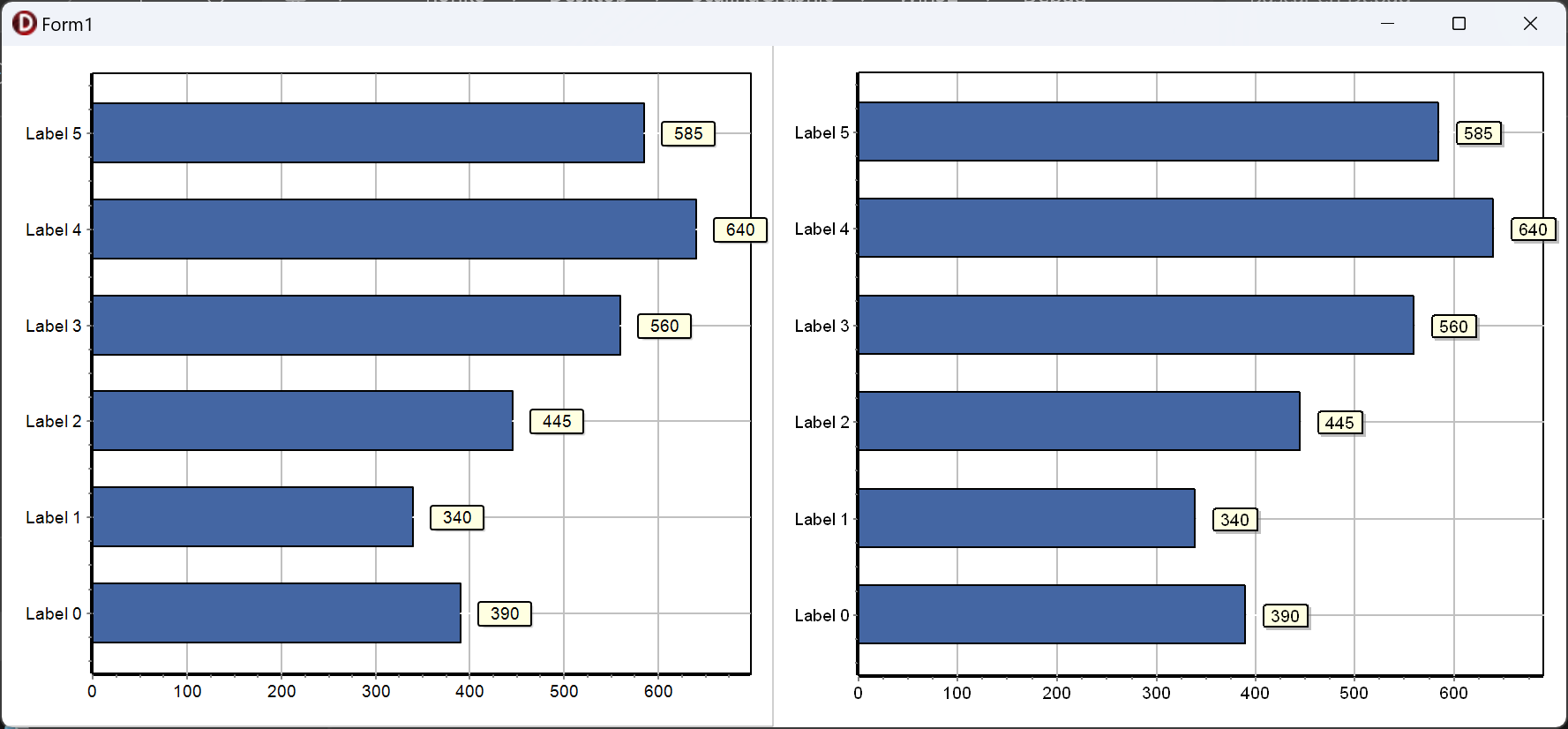

I've copied your code to a simple example with just a THorizBarSeries, and this is how it looks for me:
ScalingGraphic.zip
(2.29 KiB) Downloaded 4860 times
At 100%:

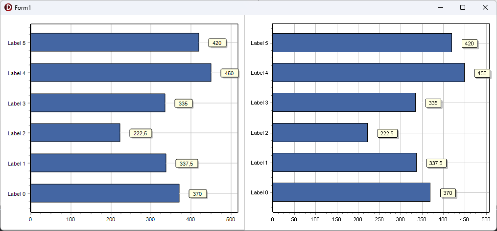

At 175%, the forums seem to rescale the image - open it in a new tab to see the real size:
