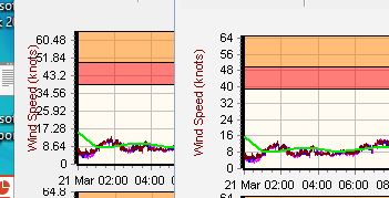

I've just upgraded from 2021.32.210430 to v2023.39 (231109) which seems to have a y-axis drawing difference.
As the image shows attached the left graph has for example 60.48 on the y-axis while on the previous version this would be 64, 56, 48 etc. Axis min = 0 and max = 65. It draws correctly with more space but if window is small its adding the dp's.
The AxisValueFormat is still the default graph_->LeftAxis->AxisValuesFormat = "###0.###";
I can reduce set ###0 which restricts it but wondering why the values produced are so different ?
Is this an issue with the new VCL TChart ?

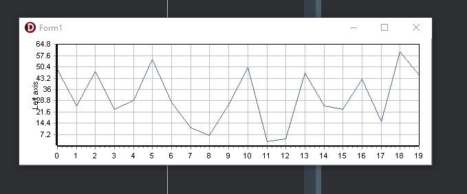

Post by bdw » Tue Mar 26, 2024 9:09 pm
Only just had a chance to re-look at what the code we have is doing.
We also have the Axis.Left.Increment := 1 set in this case to try and reduce the number of y-axis labels rather than automatic.
With that setting in the past it still kept the y-axis labels clean rather than having the in the example 64.8, 57.6 etc
I've not tested that code on the older release yet but will try shortly

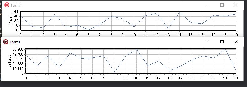

Ok I've tested with the two TChart version listed previously and as you can see with the same code the graphs look quite different.
Top one is v2021.x and bottom v2023.x

Re: v2023.39 (231109) y-axis label issue
Post by Yeray » Wed Mar 27, 2024 9:55 am
Indeed setting Increment to 1 was the key to reproduce the problem.
I've added it to the public tracker: #2690
