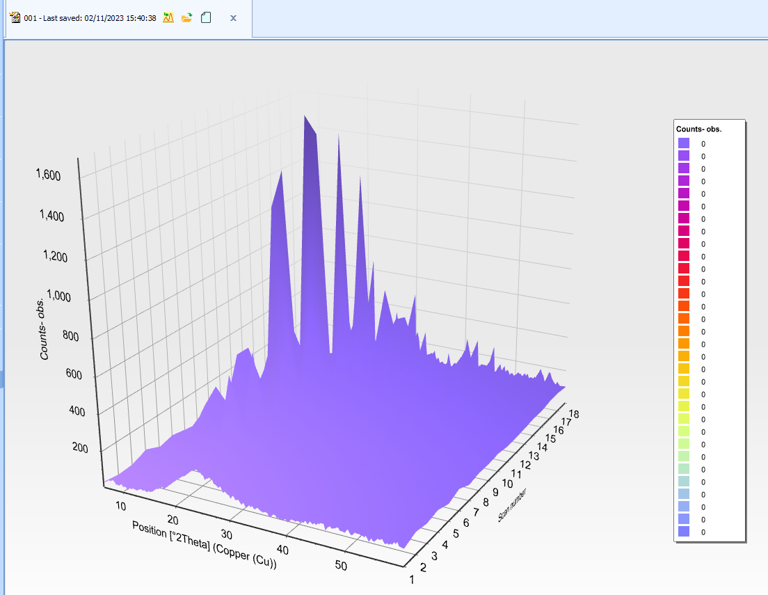

There is a problem/bug since the latest version of TChart VCL, with the Display of 3DGridSeries when "UsePalette" is set/used.
Everything is displayed in just ONE color and the Legend just shows Zeros.

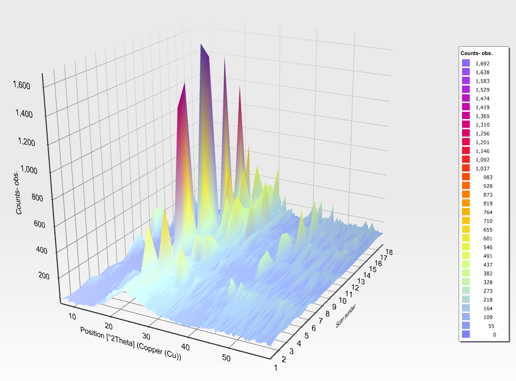

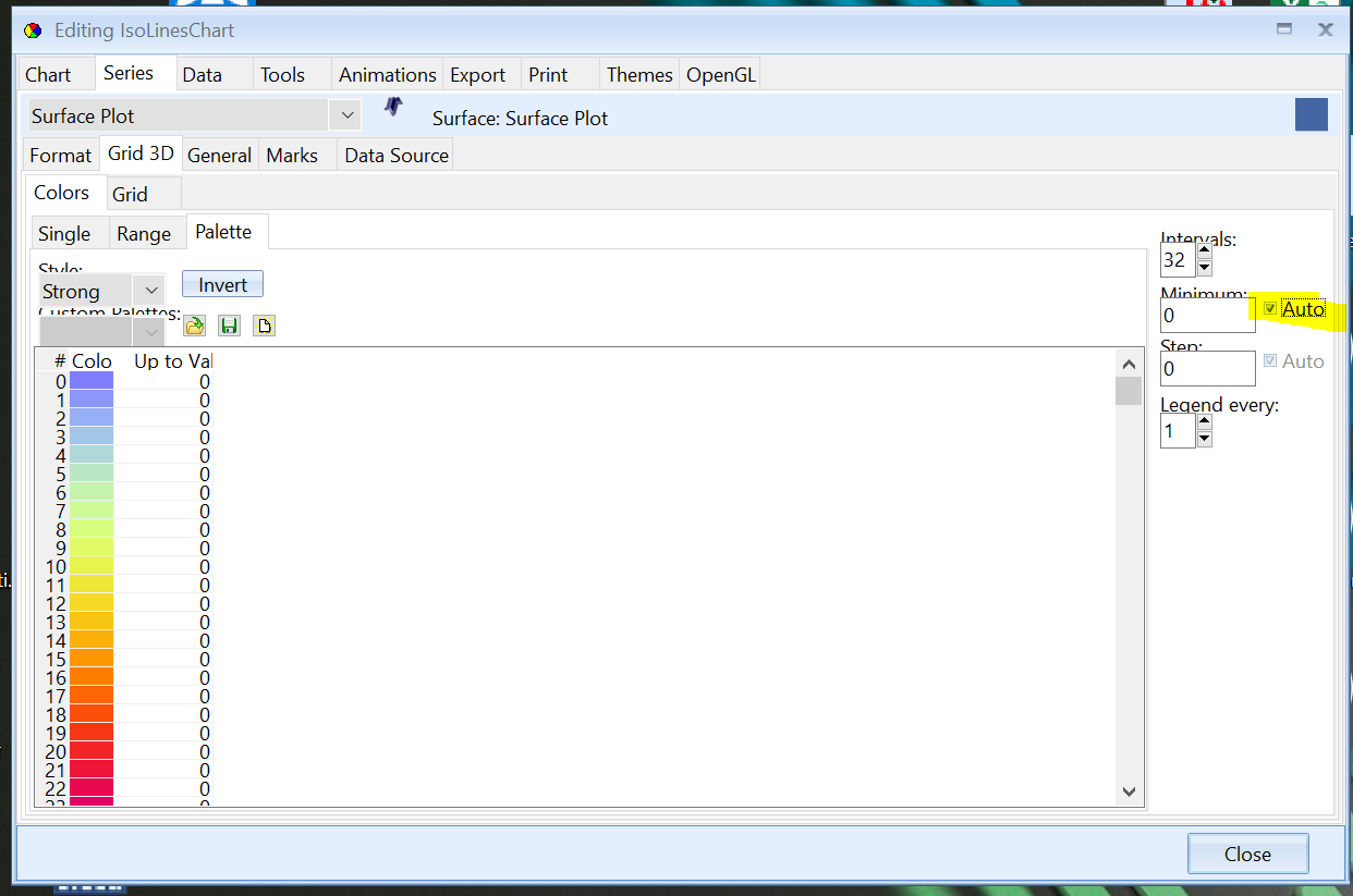

When I then go into the Chart dialog and Set "UsePaletteMin / Auto" to TRUE :
Its starts to get "normal":
Note that we do all Chart operation in code and when I set "UsePaletteMin" to True for the 3DGridSeries in Code, that
doesn't help, we still get the ONE Color Chart and zeros in the Legend. Only when I open the TChart Editor Dialog things get correctly updated. Is this bug known and fixed already?

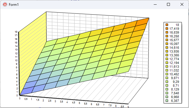

When the chart is being drawn, the CheckPaletteEmpty method should be called, which calls CreateDefaultPalette in these conditions:
// Default palette should be re-created when: series has data, and
// when palette is empty or "dirty" and not custom.
Procedure TCustom3DPaletteSeries.CheckPaletteEmpty;
  if (Count>0) and ( (Length(FPalette)=0) or (IDirtyPalette and (not ICustomPalette))) then
     CreateDefaultPalette;
This simple example seems to correctly initialize the palette for me here:
uses Chart, TeeSurfa;
var Chart1: TChart;
var x, z: Integer;
  Chart1:=TChart.Create(Self);
  with Chart1 do
    Parent:=Self;
    Align:=alClient;
    Color:=clWhite;
    Gradient.Visible:=False;
    Walls.Back.Color:=clWhite;
    View3DOptions.Orthogonal:=False;
    Chart3DPercent:=100;
    Aspect.Zoom:=75;
    with TSurfaceSeries(AddSeries(TSurfaceSeries)) do
      UseColorRange:=False;
      UsePalette:=True;
      for x:=0 to 9 do
        for z:=0 to 9 do
          AddXYZ(x, x+z, z);
Do you see if I'm missing anything here?
