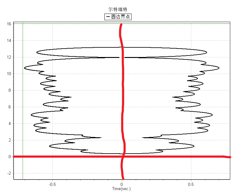

How to draw the red axis on a graph?
Using c++builder。
How to draw an axis

How to draw an axis
- Snipaste_2023-08-16_16-00-10.png (16.23 KiB) Viewed 30443 times

you can do this by using the ColorLine Tool (two, one for vertical and another one for horizontal).
You can find an example of use of the ColorLine tool in the TeeNew examples features included with the installation.

I can't find it. Can you give me a demo?

you can use the following code to add a colorline tool and then customize it.
Please, let us know in the case any help still needed.
//Now add colorlinetool outside the min/max range of the data
TColorLineTool *line = new TColorLineTool(TrendChart);
TrendChart->Tools->Add(line);
line->AllowDrag = false;
line->NoLimitDrag = false;
line->Axis = axisVert;
line->Pen->Color = clBlue;
line->Pen->Width = 2;
line->Value = 32;
What is axisVert???
What is axisVert???
Re: How to draw an axis
axisVert was used in the case you want to make use of a new custom axis, like:
but you can always use instead:
//Add vertical axis
TChartAxis *axisVert = new TChartAxis(TrendChart);
axisVert->Maximum = dblMax + 1;
axisVert->Minimum = dblMin - 1;
axisVert->Grid->Visible = true;
axisVert->Automatic = false;
axisVert->AutomaticMinimum = false;
axisVert->AutomaticMaximum = false;
axisVert->PositionPercent = 0;
axisVert->Horizontal = false;
axisVert->OtherSide = false;
axisVert->Visible = true;
axisVert->LabelsFont->Color = clRed;
Chart->Axes->left
