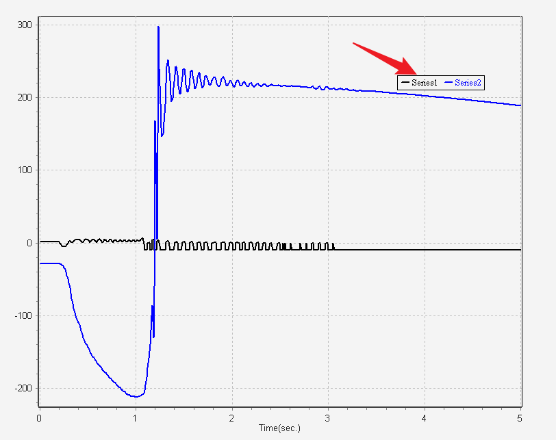

How to prohibit dragging legends?

Why is it possible to drag by default?
How to prevent the legend from being dragged?

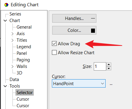

I found the reason。
I added a selection tool to achieve drag and drop annotation functionality。
This causes the legend to also be dragged. How to solve this problem???

Indeed, the TAnnotationTool doesn't support dragging. However, the TRectangleTool does.
So, instead of having a TAnnotationTool and adding a TSelectorTool to add dragging support to it, you could just use a TRectangleTool.

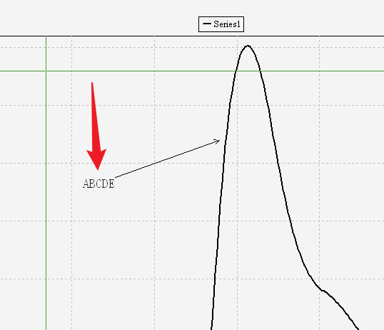

Due to requirements, I can only use Annotation. How can I prevent dragging legends?
Please provide a demo of c++builder。
Re: c++builder How to prohibit dragging legends
Post by Yeray » Fri Jul 28, 2023 2:27 pm
You can't make the TSelectorTool not to detect the Legend. So, instead of using the TSelectorTool, I'd implement the TAnnotationTool dragging myself.
