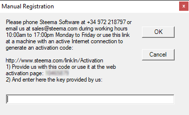

I understand that frustration. We discussed about possibilities to solve the situation but it turns out that the maintainer of the server did a OS upgrade which doesn't support old SSL/TLS version for security reasons.
Since we found this the day after publishing a TeeChart VCL release, we decided to rebuild those installers with the updated activation utility and make the activation form page more visible.
I'm afraid we can't rebuild the older installers. And moving to a server without that update would expose us to a security risk.
Our apologies.
Finally note, the activation page is also mentioned in the installer, when the connection fails and you choose "manual registration":
https://www.steema.com/linkIn/Activation
