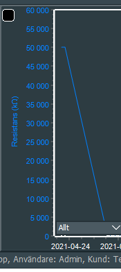

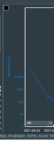

I attached two images showing my chart. One with LogarithmicBase set to False and the other one with LogarithmicBase set to true. This is the only modification done in the program between the two screenshots. Min, max values are set to 0 - 60000.
Why is the Log view only occupying half screen? I have used the program for ages without any problems but sometime last year this problem started when compiling new versions..
Best regards, Mikael
Logarithmic view
Linear view
