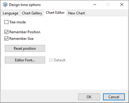

Re: Recompilation tool issue
Posted: Fri Dec 16, 2022 7:46 am
by yeray
I see the error in "Tree mode". We'll investigate what's wrong.
Meanwhile, please open the "options" and uncheck it.

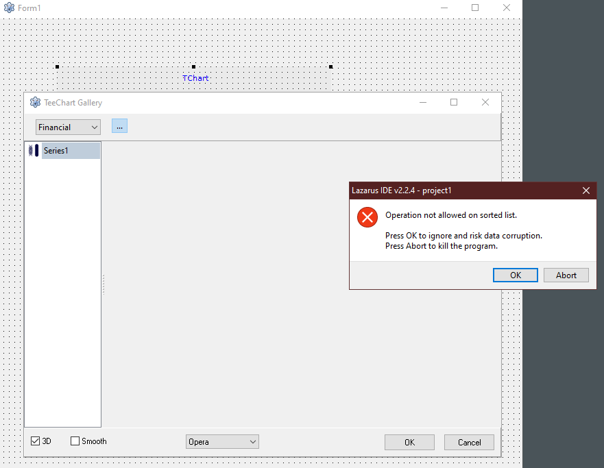

Posted: Fri Dec 16, 2022 2:53 pm
by 16594950
When doing so I can get a little further but upon choosing an item from the gallery it stops with...
Screenshot 2022-12-16 094742.png (91.47 KiB) Viewed 18992 times
Screenshot 2022-12-16 094311.png (19.27 KiB) Viewed 18992 times
Posted: Mon Dec 19, 2022 7:33 am
by yeray
At TeeGally.pas, find the TTeeGallery.SwitchAlternate procedure and modify this line:
      ChartListBox1.Sorted:=True;
For this:
      {$IFNDEF LCL}
      {$ENDIF}
And rebuild the package.
I'm sorry for the inconveniences.

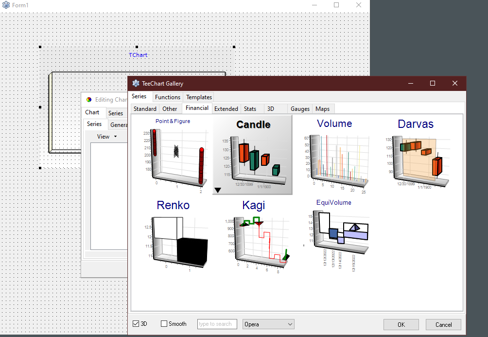

Posted: Tue Dec 20, 2022 4:30 am
by 16594950
That got rid of the sort error, but things are odd.
If you choose something from the series gallery the associated code is not generated and if you do too much in the gallery it crashes.
Here are some screenshots...
Screenshot 2022-12-19 231759.png (30.32 KiB) Viewed 18766 times

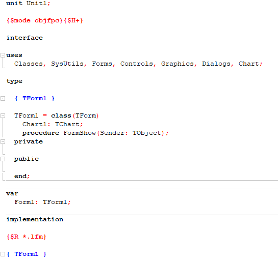

The resultant code:
Screenshot 2022-12-19 231827.png (14.85 KiB) Viewed 18766 times

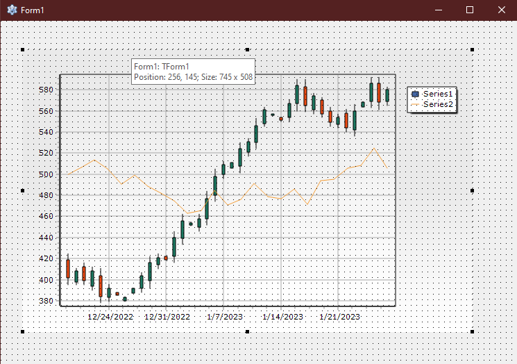

After making changes to a series from the gallery, like checking "smooth" etc.:
Screenshot 2022-12-19 230806.png (30.75 KiB) Viewed 18766 times
