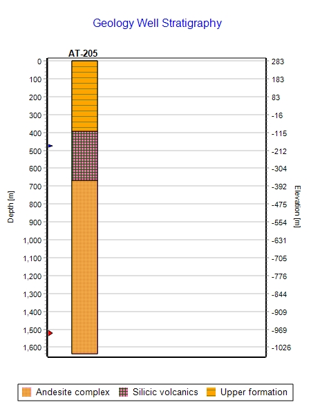

I use TeeChart with a Self Stacked bar chart to visualise the stratigraphy down a well. I have code to generate the legend as shown in the attached image, Stratigraphy.jpg.

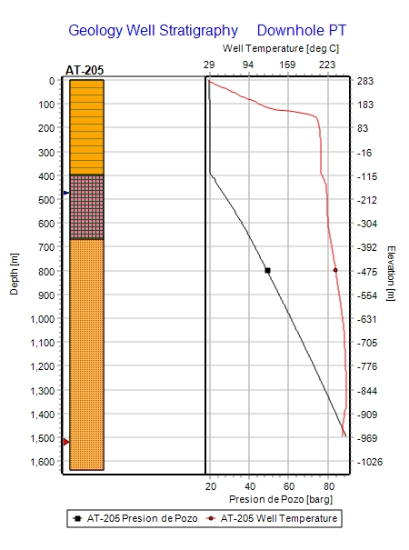

However, I wish to create a split-chart with the stratigraphy on the left and a line chart on the right, I am unable to show both legends, as in StratigraphyPT.jpg. How can I place both legends on the chart. I would prefer to be able to create an ExtraLegend and then assign this to the series at the appropriate point.
I have created an ExtraLegend tool as shown below, but I don't understand how to now apply the legend code to the ExtraLegend.
  if self.owner.fToggleSecondWorksheet then
    ExtraLegend := TExtraLegendTool.Create(self.owner);
    self.Owner.Chart.Tools.Add(ExtraLegend);
    ExtraLegend.Series := TUnitBarSeries(SeriesListB.Objects[iIndex]);

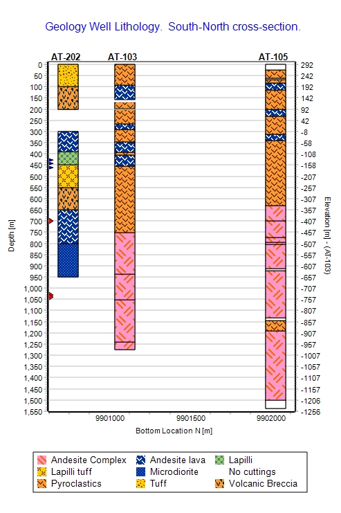

Thank you for your reply. I have reviewed your sample code, but I am still puzzled on how to proceed. In my code, I use a single chart and a single legend for any number of line series (see multiline.jpg with 4 series and a single combined legend). Similarly, for bar charts (multigeology.jpg).
When I make a chart with both line and bar charts, I would like to simply assign the bar chart legend (a composite legend of all rock types in the selected series) to an ExtraLegend, rather than change all my code to refer to chart[0], chart[1] etc, as would seem to be necessary if I added each series to the chart. Is this possible?

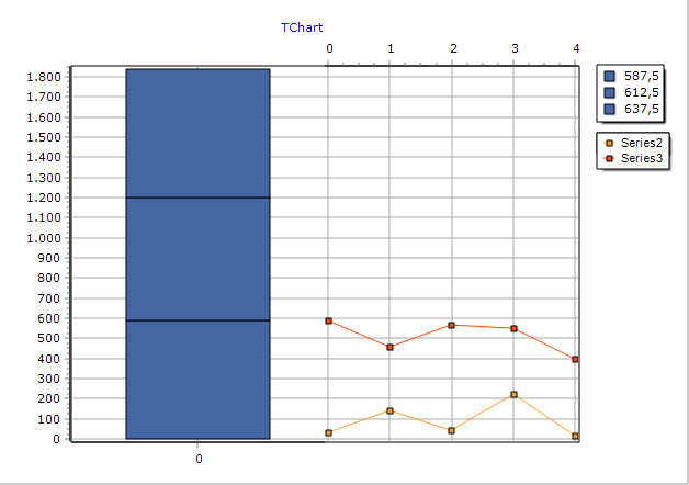

Hello Errol,
If you want TBarSeries in the main series and TLineSeries in the extra legend, you can loop all the series and activate/deactivate ShowInLegend according to the series class:
uses Series, TeeExtraLegendTool;
type TMyExtraLegendTool=class(TExtraLegendTool)
  protected
    procedure ChartEvent(AEvent: TChartToolEvent); override;
TLegendAccess=class(TChartLegend);
procedure TMyExtraLegendTool.ChartEvent(AEvent: TChartToolEvent);
var i: Integer;
  if AEvent=cteAfterDraw then
    for i:=0 to ParentChart.SeriesCount-1 do
        ParentChart[i].ShowInLegend:=ParentChart[i] is TLineSeries;
    if Assigned(ParentChart) and Assigned(Series) then
      if Legend.Visible then
        TLegendAccess(Legend).CalcRect;
        Legend.DrawLegend;
procedure TForm1.Chart1BeforeDrawChart(Sender: TObject);
var i: Integer;
      Chart1[i].ShowInLegend:=Chart1[i] is TBarSeries;
var i: Integer;
  Chart1.View3D:=False;
  Chart1.Color:=clWhite;
  Chart1.Axes.Bottom.EndPosition:=50;
  Chart1.Axes.Top.StartPosition:=50;
  Chart1.OnBeforeDrawChart:=Chart1BeforeDrawChart;
  with TBarSeries(Chart1.AddSeries(TBarSeries)) do
    MultiBar:=mbSelfStack;
    Marks.Hide;
    FillSampleValues(3);
  with TLineSeries(Chart1.AddSeries(TLineSeries)) do
    HorizAxis:=aTopAxis;
    Pointer.Show;
    Pointer.Size:=2;
    FillSampleValues(5);
    Pointer.Show;
    Pointer.Size:=2;
  Chart1.Draw;
  with TMyExtraLegendTool(Chart1.Tools.Add(TMyExtraLegendTool)) do
    Series:=Chart1[1];
    Legend.LegendStyle:=lsSeries;
    Legend.Left:=Chart1.Legend.Left;
    Legend.Top:=Chart1.Legend.Top+Chart1.Legend.Height+10;
