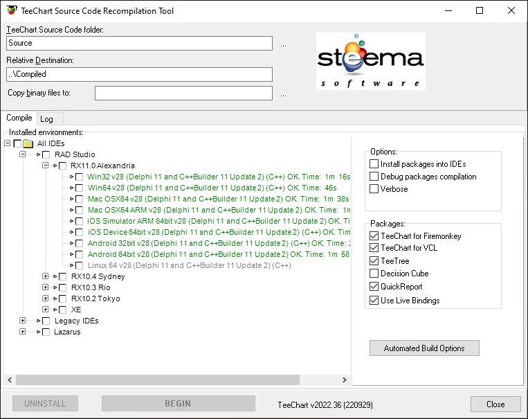

That's strange. It builds without issues for me:
Can you try downloading the installer again?

In the meanwhile, you should be able to correct the "Source\TeeConst.pas" is as follows and run TeeRecompile:
Line 612:
TeeMsg_Copyright :={$IFDEF LCL}'(C)'{$ELSE}'©'{$ENDIF}+' 1995-2022 by Steema Software';
Line 1014:
TeePolarDegreeSymbol        :='°';

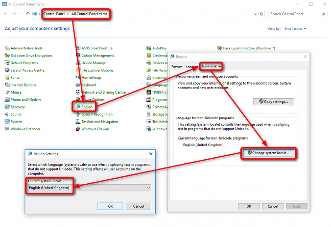

An alternative is to change your system locale as follows:
