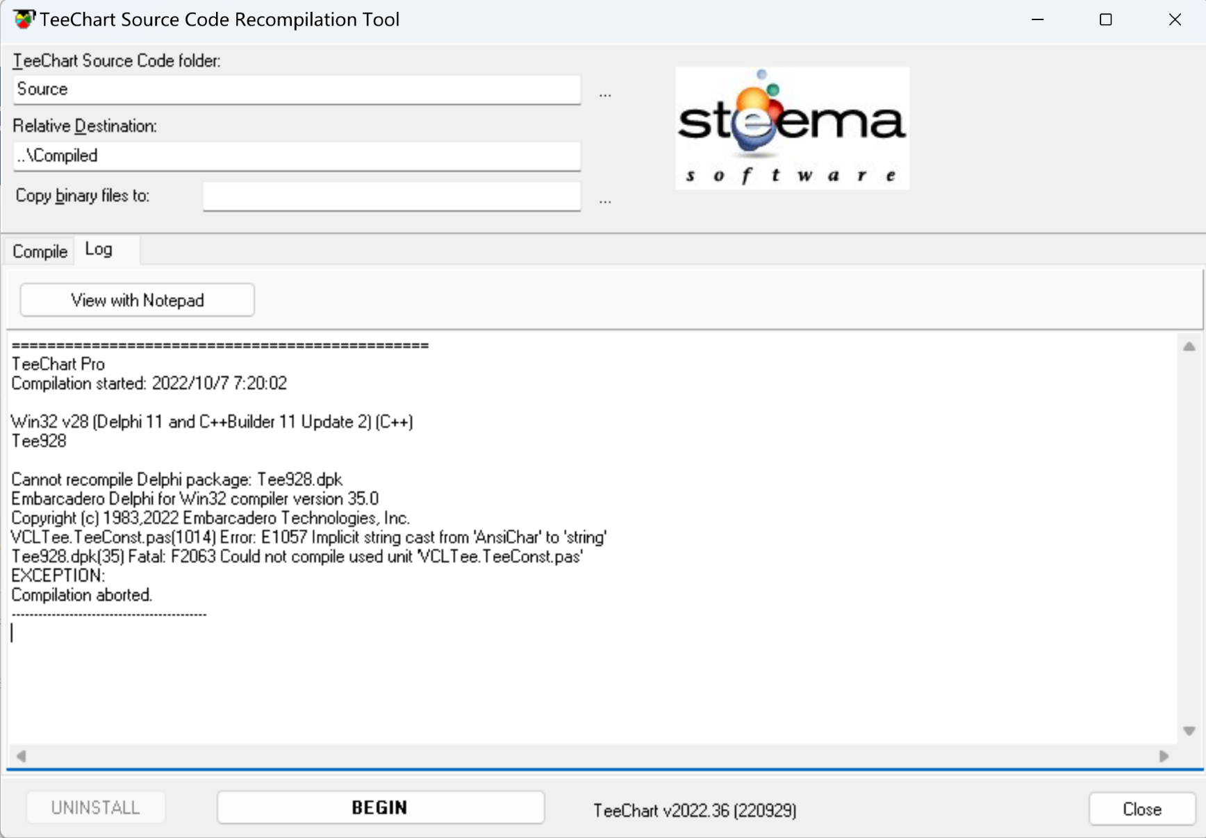

Re: Cannot recompile Delphi package: Tee928.dpk
Thanks for the reply.
I still encountered the same error message after re-downloading and installing, my IDE version is RAD Studio 11.2 Patch 1 (28.0.46141.0937).

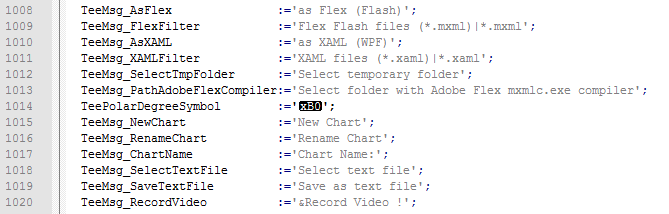

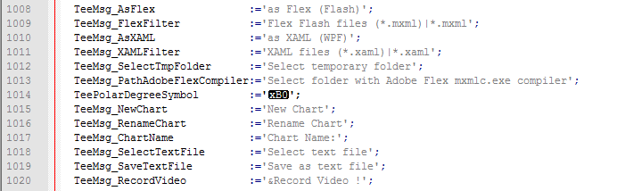

No, in notepad++ it looks like gibberish:
- TeeConst.pas
- TeeConst.png (19.32 KiB) Viewed 14736 times
- VCLTee.TeeConst.pas
- VCLTee.TeeConst.png (19.44 KiB) Viewed 14736 times

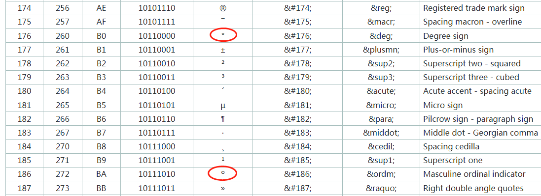

I need your help.
I tried to use hexadecimal characters to represent this gibberish-looking symbol, but I found two symbols in ASCII Code that are very similar to it, Should I choose #B0 or #BA ?
I need your help.
- ASCII.png (46.3 KiB) Viewed 14732 times
It's the degree symbol/sign, B0

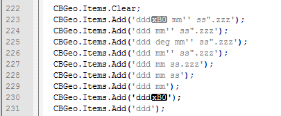

I changed line 1014 to:
Compile again, an error is reported on line 612, it seems that '©' is not correctly recognized.
So I replace it with #$A9:
continue to compile, this time it returns to line 1014 to report an error:
VCLTee.TeeConst.pas(1014) Error: E1057 Implicit string cast from 'AnsiChar' to 'string'.
I don't know where the problem is, so I had to copy and paste the code you showed above and continue compiling. This time it was the VCLTee.TeeFormatting.pas file, line 612, and I opened it and found that it seemed to have the same problem as the VCLTee.TeeConst.pas file, line 1014, which made I feel very sad, what's the problem?
This is my system information: Windows 11 enterprise, version 22H2 Build 22621.521, Simplified Chinese, is there something wrong with my operating system character set?

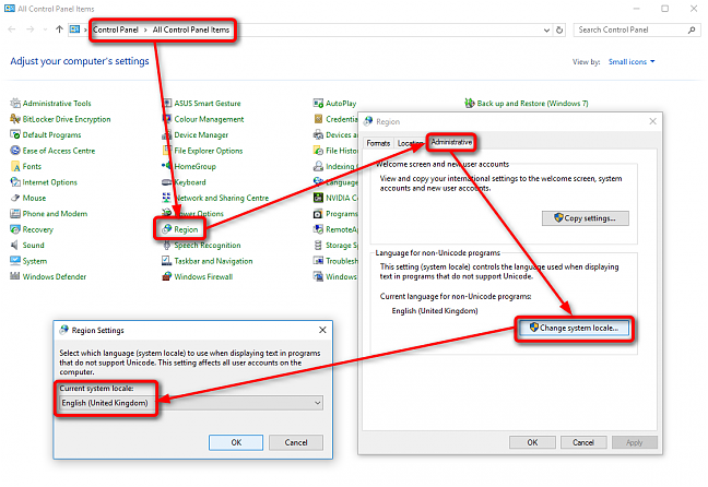

An alternative is to change your system locale as follows:
