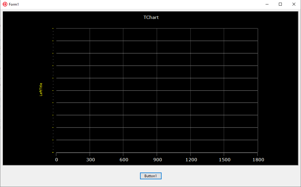

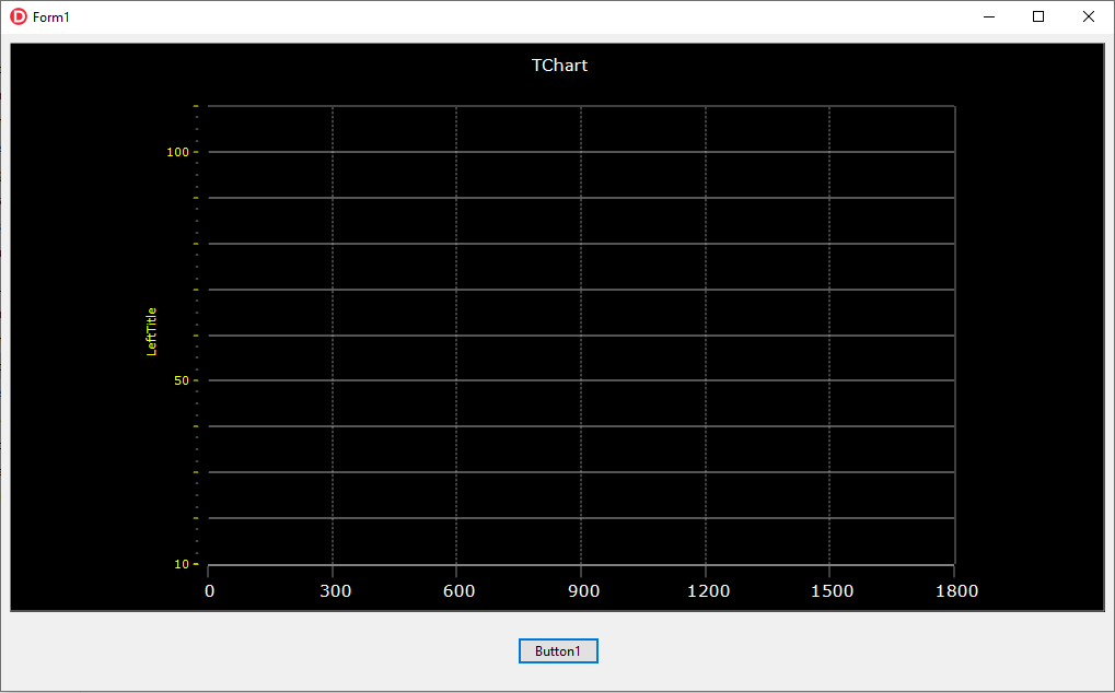

I have a problem with axis labels. The problem appears when I move the mouse over an axis or add a new value to the series, the labels of the axes disappear. The chart configuration is by code-
I attached an example and pictures.
I am using delphi 10.5 and 11.
After moving the mouse on an axis
Captura de pantalla (124).png (13.85 KiB) Viewed 4640 times
Before moving the mouse on an axis
Captura de pantalla (123).png (14.42 KiB) Viewed 4640 times

I've been able to reproduce the problem so I've added it to the public tracker (#2550) and I've already fixed it for the next maintenance release.
